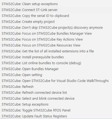

Neither cube pack install STMicroelectronics.stm32u3xx_dfp.1.0.0 nor STM32Cube: pack install STMicroelectronics.stm32u3xx_dfp.1.0.0 succeeded.
Such a command seems not to exist. I have attached all other available STM32 extension commands below.

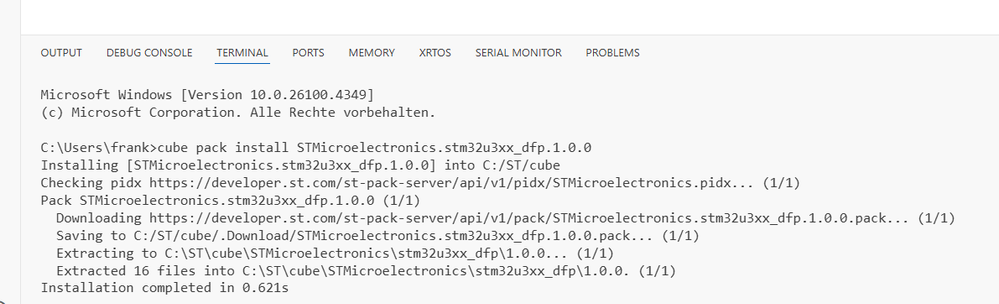

This command is to be entered in the terminal, not in the command palette:
hth

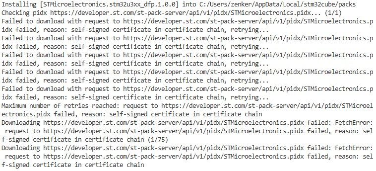

Hallo KnarfB,
thank you so much. My fault. I'm new with VS Code (worked for years with CubeIDE).
There seems to be a problem with certificates. May be an IT problem.

This is indeed an IT issue, all what you should need is to define NODE_EXTRA_CA_CERTS system variable to point to a bundle CA certificates file. Your local IT must be in a position to share this file with you.

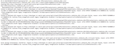

After getting the certificates and the CA bundle file from my local IT and applying it (set NODE_EXTRA_CA_CERTS systems variable to the bundle file and the certificates), the result looks like this:
Failed to download with request ..., reason: write EPROTO F8290000:error:0A000152:SSL routinesfnlr:final_renegotiate:unsafe legacy renegotiation disabled
I gues much more IT problems - surely on my side.

Hallo Julien,
I have no openssl installed.
However, I did complain to my company IT again. They solved the problem now. Some server side internal IT stuff I have no insight to. Now it works.
