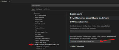

mx not launched with prerelease
dvescovi
the release version 2.1.1 launches just fine and i have the paths set for mx and finder.
pre release 3.4.11 does not launch from key actions
dvescovi
working now. didn't have .exe

New extension ... I bet new setting ID. Let's contribute to this I guess:
I already have that set ... still does not work
Cartu38 OpenDev
Lead III
"I already have that set ... still does not work" .. any special char in use ? Not main disk in use ? ... looking for common root source which may lead to issue ...
Could you possibly share snapshot of your setting (like mine) ?

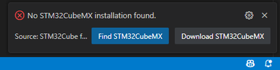

Hi @dvescovi
could you please share the output log or screenshot please ?
dvescovi
@dvescovi ok Thanks for keeping us up to date !
No notification was complaining about ? On my side I'm getting :
