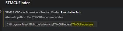

i've just installed all necessary requirements for the STM32 vscode extension however it doesn't seem to launch cube mx or mcu finder when i click launch from vscode. not sure if its incorrect paths or permission issues?
please see the screenshot for the path settings

Hello all,
For everyone that came across this issue, for "Launch STM32CubeMX", "Launch STMCUFinder", you have to set the executable path not only the path of the folder, it should be something like this for windows:
And something like this for mac:
Home\xx\STMCUFinder\STMCUFinder
Home\xx\STM32CubeMX\STM32CubeMX
Hope that helps!

I have the STM32 VS Code extensions installed on my Macbook, along with STM32CubeMX and STMCUFinder, both installed in their default installation path ($HOME).
STM32CubeMX launched fine. But I had to change the settings for the location of STMCUFinder in order for it to work.
/Users/rob/STMCUFinder.app -> /Users/rob/STMCUFinder.app/Contents/Resources/STMCUFinder
This is the configuration for STM32CubeMX:
/Users/rob/STM32CubeMX.app/Contents/Resources/STM32CubeMX
In VS Code, open settings, search for STMCUFinder and change the installation path. It sounds like you will need to do the same for STM32CubeMX as well.
