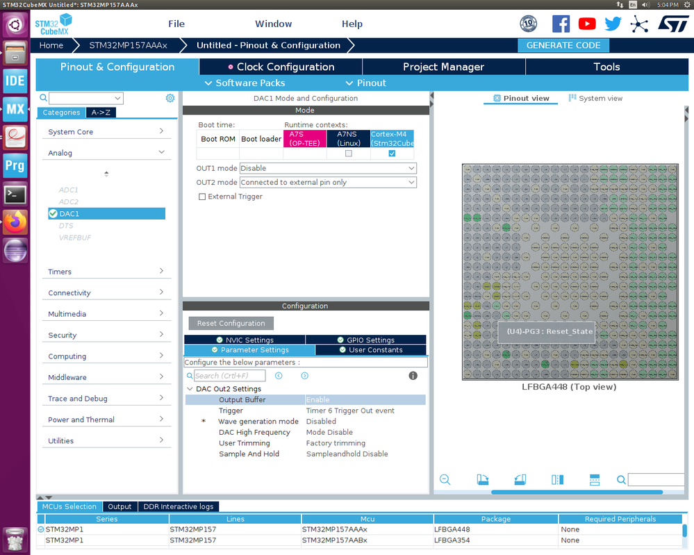

We are using Stm32mp157a Processor in Our custom board.
We are configuring PA5 as DAC1_OUT2.We want to configure DMA for DAC. But we didnot get an DMA setting tab in DAC configuration in stm32 Cube mx.How do i enable DMA for DAC? You can see in below Attachment.

Hi @Sindhu Vadde​ ,
you are right, seems missing on STM32CubeMx.
I think feature is available inside STM32CubeMP1 HAL by manually adding relevant inits and function calls in your code.
We are checking this internally and come back to you.

We are adding DMA for DAC Manually But when we Check CR register It is not enabled.You can see my procedure of adding DMA manually to DAC below.
1.DMA initialization Function.

In between  /* USER CODE BEGIN DAC1_MspInit 1 */ and /* USER CODE END DAC1_MspInit 1 */ we added by us.
Is there any mistake in adding DMA manually.
Correct me where i did wrong in my code.
No evident mistake.
Did you assign a timer (seems you use TIM6 in first figure) to DAC trigger ?
Did you started the associated timer ?
Did you use HAL_DAC_Start_DMA() ?
Regards.
Tip of the day: Try Sidekick STM32 AI agent, see here
yes we use timer 6 for triggering dac and we started Timer then we used HAL_DAC_Start_DMA() but there is no wave on DAC line.But When we use no trigger withour starting dma and timer we get some wave by using
