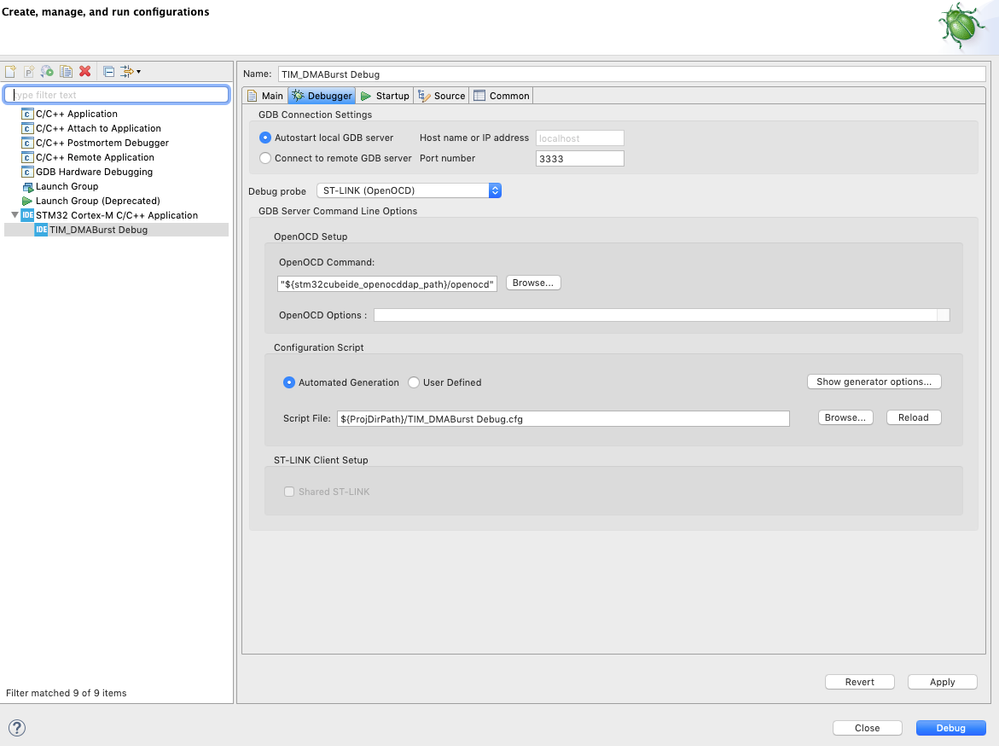

I use STM32Cube v1.10 on macos(Mojave) and linux(debian 9). The debug dialog has load mode option to choose production or engineering mode in stm32cubeide on linux system. But that dialog hasn't the load mode on macos.
Below picture is debug dialog on macos.
0690X00000BvtBbQAJ.pngDoes any thing I am missing to setup for stm32cubeide?

I confirm that MP1 is not supported in MacOS CubeIDE version.
Sorry for inconvenience.

Sounds STM32MP1* targets debug are not supported by STM32CubeIDE if MacOS. Please have a look at your IDE install. If Linux or MacOS some OS related plugins are lacking.
This is the correct answer.
Did you import the project from Linux to mac? Because if you try to create a new MP1 project through macOS then you should receive a dialogue telling you that there's no support for MP1 in macOS yet.
I am import these projects of stm32cubemp1 package into stm32cubeide on MacOS. On the import progress, the stm32cubeide show me some convert dialog and success tips. These converted projects can be build successful. I also confirm the "unsupported target selection" dialog when I select the stm32mp157 chip in new stm32 project process.
Well, that can be confusing for sure. The converter still converts the project successfully and it's the same builder so there shouldn't be any issues with that either. However, I believe it's the MP1 specific debug that hasn't been implemented yet.

Olivier is not exactly correct about absence of MP1 support.
here is what you have to do to make MacOS CubeIDE working for M4 onboard core:
  1. switch to the (whatever it's been named) boot mode Boot0 = 0, Boot2 = 1
  2. copy over from the linux CubeIDE whole plugin folder: plugins/com.st.stm32cube.ide.mpu.debug.openocd_1.5.0.202011161118 into /Applications/STMicroelectronics/STM32CubeIDE.app/Contents/Eclipse
  3. copy over missing target/stm32mp1x.cfg file from plugins/com.st.stm32cube.ide.mpu.debug.openocd_1.5.0.202011161118/resources/openocd/st_scripts/target/stm32mp1x.cfg to plugins/com.st.stm32cube.ide.mcu.debug.openocd_1.5.0.202011091203/resources/openocd/st_scripts/target
