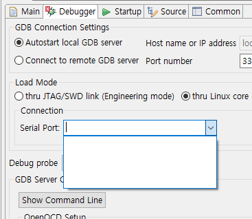

‎2023-04-04 7:59 PM
Hello @Wijeden RHIMI
1.It worked before, but now it doesn't. I uninstalled and reinstalled, but it doesn't work.
2.A new project was created in a new workspace, but there was a problem that ST-Link Serial Port could not be found.
3.I tried rebuilding after "Clean project", but it doesn't work.
Is there any way to solve this?
KNam​
‎2023-04-04 10:56 PM
I solved the problem. The serial port was resolved by setting it in Preferences.
[Window] -> [Preferences] -> [STM32Cube] -> [MPU Serial] / Check Remove filter
And in the new workspace there were no problems. However, the problem occurs only in the problematic workspace.
[workspace in problem] D:\project\Source\STM32Cube
[New workspace] D:\proejct\Source\STM32Cube\workspace1.12.0
It is presumed that the cause of the problem is, firstly, that the Remove filter was not set, and secondly, there was a problem with the workspace.
Thank you for your attention.
