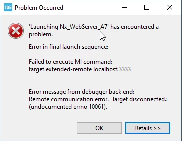

Dears,
I am able to compile Nx_WebServer demo. But when I try to run/debug it will halt.
I read all notes in NetXDuo/Nx_WebServer/readme.html - the last chapter "How to use it ?"
  • Open your preferred toolchain
  • Rebuild and run DDR_Init example to initialize the DDR memory
  • Rebuild all files and load your image into target memory
  • For STM32CubeIDE, in order to keep DDR initialized, please remove “monitor reset” line in “Debug Configurations->Startup>Initialization Commands”
  • Run the application
But I end on red line - unable load image - Where could be problem ?
I am able to compile and debug another aplication ftom STM32Cube_FW_MP13_V1.0 like UART, ADC examples withou error.
Error in final launch sequence:
Failed to execute MI command:
target extended-remote localhost:3333
Error message from debugger back end:
Remote communication error. Target disconnected.: (undocumented errno 10061).
Console log:
Info : SWD DPIDR 0x6ba02477
Warn : target STM32MP135FAFx.ap1 examination failed
Warn : target STM32MP135FAFx.axi examination failed
Error: Could not initialize the APB-AP
Warn : target STM32MP135FAFx.cpu examination failed
Info : gdb port disabled
Info : starting gdb server for STM32MP135FAFx.cpu on 3333
Info : Listening on port 3333 for gdb connections
Info : accepting 'gdb' connection on tcp/3333
Error: Target not examined yet
Error executing event gdb-attach on target STM32MP135FAFx.cpu:
Info : New GDB Connection: 1, Target STM32MP135FAFx.cpu, state: unknown
Error: Target STM32MP135FAFx.cpu not examined yet, refuse gdb connection 1!
Error: attempted 'gdb' connection rejected
shutdown command invoked

Dear @ravo
I do not reproduce this error at my end in running this particular example after following the readme file.
This typical error msg usually indicates that
1- you haven't run the DDR init example prior running the NX_webserver project
2. you haven't changed the NX_webserver/debug properties as mentioned in the readme file (please remove “monitor reset” line )
Board boot pins must be set in "Engineering boot mode" But you said you were already familiar with other HAL examples so I don't think this was your issue.

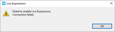

Small update,
I have looked that blue led is blinking (after DDR_Init - but only when it is running in DEBUG mode, when RUN then nothing...)
Then I am able to start DEBUG for NETX Duo application... But then it will show warning...
When I push Resume button, then it will start...
I got info in UART that project is running. But unable to continue...
When stop and restart debug once more it will never send data to UART...
May I doing still something wrong ?
Regards
Radim

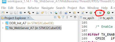

Hi @ravo
Yes, CubeIDE projects are made to be debugged directly in Engineering mode by plugging a stlink usb cable,
I use the bug button to enter debug:
It means you need to run the DDR_init example first, if properly done you should see the blue led toggling (DK-board) indicating the DDR is properly initialized. Once there, you should quit the DDR init project without resetting the board.
  • Build the Nx_WebServer_A7 project as is.
  • Modify the Nx_WebServer_A7 project debug configuration ( remove "monitor reset")
  • Enter debug.
Regarding the projet build itself, there is nothing to change it works as is. If you want to enable the  Nx_WebServer_A7 debug symbol  you can modify :
  • Nx_WebServer_A7 project properties/ C/C++ build/Settings/MCU GCC Assembler/Debugging -> Debug level Maximum.
  • Nx_WebServer_A7 project properties/ C/C++ build/Settings/MCU GCC Compiler/Debugging -> Debug level Maximum.
