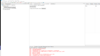

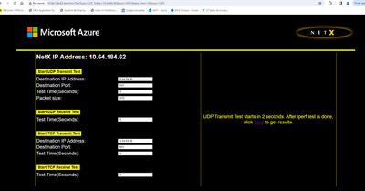

In terminal I got only "Nx Iperf application started.." but no info about IP address, etc. no more logs... Is it normal ? Must I to set something more to view them ?
I setup with static IP address 192.168.0.2 instead of using DHCP

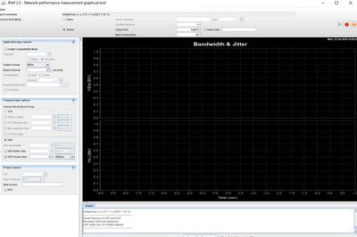

and I can only test UDP server mode (IPERF mode client) show on picture:
All others variants end with connection errors...

Hello @ravo,

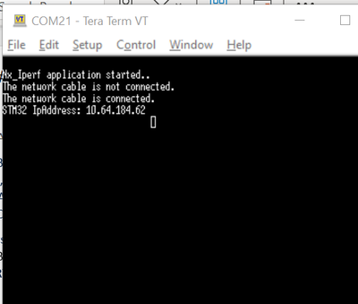

First the ethernet cable must be connected and a terminal launched.
After you load the code in DDR, and resume it, the cubeIDE won't be able to show the sources:
in a terminal windows, you should see this:

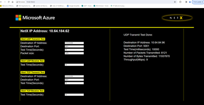

and then you can try with your favorite browser (http://IP@) thesame ip you saw in the terminal:(
then start the Jperf tool and run it
press start UDP transmit in the web page

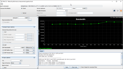

and check the jperf tool:
and finally you can check everything is OK in the browser by clicking "here" in the right pan:
I hope it will help you
For the TCP transmit, you can do it with TCP selected instead of UDP in the Jperf tool.
regards
David
‎2024-02-12 2:10 AM
Hello @ravo,

‎2024-02-12 2:21 AM - edited ‎2024-02-12 2:22 AM
Dear @DBELL.1 ,
I am doing it in same way as you wrote. But I got only response in terminal "Nx Iperf application started.." no another info...
Rj45 cable is connected to ETH1.
Regards
Radim
‎2024-02-12 2:39 AM
Hello @ravo ,
Do you connect the ethernet cable to a DHCP server?
And I plug it before powering the board.
When I don't plug the cable, I have no info at all in the terminal.
regards
David
‎2024-02-12 3:01 AM
Dear @DBELL.1 ,
I have connected rj45 Prior to start debug.
I use DHCP server as service app in windows 10 using usb to ethernet adapter. Main PC on this adaoter has address 192.168.0.1. In his monitor tool I see that the board is connected and got assigned address 192.168.0.2.
I also tried to disable DHCP client and set static address in netxduo initialization. Then I am able to ping stm32 board and get response for ping. But in terminal window no more information.
Regards

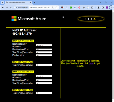

‎2024-02-12 4:44 AM - edited ‎2024-02-12 4:53 AM
Dear @DBELL.1
Maybe there was problem with DHCP server application. I setup router with DHCP and the board get 192.168.1.179 address and web server is now running:
And now all tests are working...
Thanks... so the problem was on my side.
