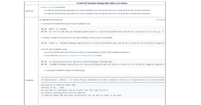

i have installed the distribution package and followed the bellow steps
and what do do now to set up qt creator?
6.1.3.2. Install X-LINUX-QT Distribution Package
To install the X-LINUX-QT Distribution Package
  • Clone the meta-st-x-linux-qt git repository
 cd <Distribution Package installation directory>
 git clone -b v1.0.0 https://github.com/STMicroelectronics/meta-st-x-linux-qt.git layers/meta-st/meta-st-x-linux-qt
  • Clone the meta-qt5 git repository
 git clone -b scarthgap https://github.com/meta-qt5/meta-qt5.git layers/meta-qt5
  • For a new environment
Source the build environment with the correct board and layers:
 DISTRO=openstlinux-weston MACHINE=stm32mp2 BSP_DEPENDENCY="layers/meta-qt5 layers/meta-st/meta-st-x-linux-qt" source layers/meta-st/scripts/envsetup.sh
  • For an already installed environment
Add the layers to the Yocto environment:
 bitbake-layers add-layer ../layers/meta-qt5 ../layers/meta-st/meta-st-x-linux-qt
and
I went with developer package as i was not able to do the distribution package
so the steps i followed for developer package was
i downloaded the MP1-DEV-x86 from st website
For x86_64 host architecture i Uncompressed the tarball file to get the SDK installation script. and Ran the SDK installation script.
for x-linux-qt developer package i downloded the below file(but my board is stm32mp157d-dk1)
i followed these steps

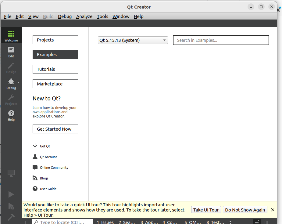

in the terminal i download qt creator using sudo apt install qtcreator and it installed  (qt 5.15.13) and u had said Qt Creator will be configured automatically and you will get your MPU kit all set in Qt creator. but i cant find anything other than Qt 5.15.13(system)
The full MP1 X-LINUX-Qt support will be available in the coming weeks.
Distribution Package allows anyway user to compile with Qt libraries and run Qt application on MP1.
But for Qt creator MP1 kit configuration, you have to do it manually.  Please refer to that post:
https://community.st.com/t5/stm32-mpus-embedded-software-and/qt-creater-setup-for-stm32mp1/m-p/706440
For MP2, the SDK-add on configures Qt creator kit automatically, but for MP1, the SDK-Addon is not yet delivered. Sorry of the inconvinience. It will be release soon.

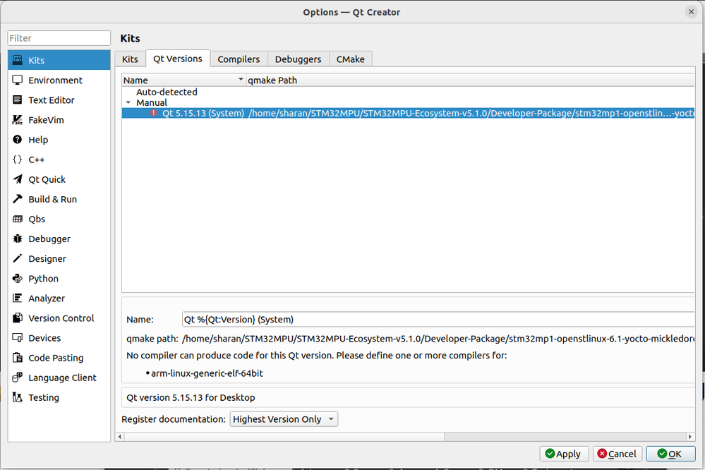

i am doing it manually it is showing no compiler can produce code for this  qt version
Please look at the post I listed before, it will describe how to get the SDK and how to use it
(bitbake st-image-qt -c populate_sdk, ...)

"bitbake st-image-weston -c populate_sdk" command is necessary to generate the SDK .sh script.
This SDK .sh script (in build-openstlinuxweston-stm32mp15-disco/tmp-glibc/deploy/sdk) has to be executed.
This will create a SDK directory you will have to refer to in Qt creator.
Qt Creator 12.x.y can be used.
