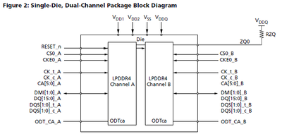

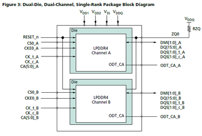

We are currently working with LPDDR4 (MT53E512M32D1ZW-046 WT:B) on our platform. To validate our setup, we used the DDR firmware code available at STM32DDRFW-UTIL, which provides drivers for LPDDR4 (MT53E1GD2FW-046 WT:C).
During our testing on the STM32MP257F-DK board, the DDR tests pass successfully with the MT53E1GD2FW-046 WT:C configuration. However, when we run the same code with the MT53E512M32D1ZW-046 WT:B device, the PHY training fails.

    • Working: MT53E1GD2FW-046 WT:C (1Gb x32, 2-die)
    • Failing: MT53E512M32D1ZW-046 WT:B (512Mb x32, 1-die)

memory seems different,
MT53E512M32D1ZW-046 WT:B  is a 16Gbit single-die dual-channel Z42M (older).
the MT53E1G32D2FW-046 WT:C is a 32Gbit dual-die dual-channel Z42N (more recent).
There is certainly some difference in the settings, please check respective datasheet and AN5723
