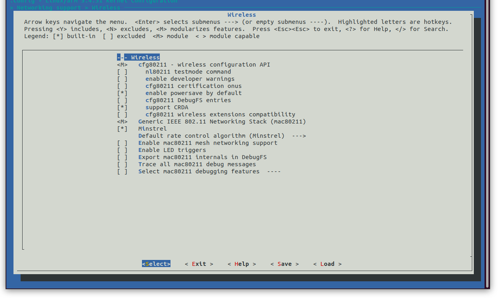

Some detail I may want to share is that in linux-menuconfig under
> Networking support > Wireless I get a "-*-" in front of "Wireless" and not a [*]
That just means the wifi got selected from another option that depends on it.
Are you using the ST provided kernel (https://github.com/STMicroelectronics/linux)?
Maybe the dmesg output will help you as well.

I am unable to test right now, but as far as I could look it up you should have that in your stm32mp157c-dk2.dts file (I didn't put it there, this is shipped with the ST Kernel (https://github.com/STMicroelectronics/linux):
/* Wifi */
&sdmmc2 {
arm,primecell-periphid = <0x10153180>;
pinctrl-names = "default", "opendrain", "sleep";
pinctrl-0 = <&sdmmc2_b4_pins_a>;
pinctrl-1 = <&sdmmc2_b4_od_pins_a>;
pinctrl-2 = <&sdmmc2_b4_sleep_pins_a>;
non-removable;
st,neg-edge;
bus-width = <4>;
vmmc-supply = <&v3v3>;
mmc-pwrseq = <&wifi_pwrseq>;
#address-cells = <1>;
#size-cells = <0>;
status = "okay";
brcmf: bcrmf@1 {
reg = <1>;
compatible = "brcm,bcm4329-fmac";
So your wifi should be indeed mentioned in your device tree. Are you trying to use the mainline kernel (aka the one buildroot suggests you by default)? The mainline one seems not to have it. As you can sse in the device tree, the driver used for the wifi should be the bcm4329-fmac.
Besides the device tree and the above mentioned device drivers I can share my Network support -> Wireless settings (see picture).
Hope it helps!

‎2020-11-26 2:38 AM
Hi
Well I managed to work it out alone actually with the help of a friend.
The solution concerns people using buildroot.
1) Invoke the Kernel configuration utility using make linux-menuconfig in your Buildroot directory on
your host machine.
2) Enable Wireless Networking support under Networking support
3) Enable cfg80211 - wireless configuration API, and Generic IEEE 802.11 Networking Stack
(mac80211), under Networking Support,Wireless
4) Enable EEPROM 93CX6 support under Device Drivers, Misc devices, EEPROM support. Required
for RTL8187 module in my Wi-Fi dongle, may not be needed for your particular adapter
5) Enable Wireless LAN driver support under Device Drivers, Network device support
6) Invoke make menuconfig within the buildroot folder from a command prompt
7) Select package iw required to configure wireless networking, under Target packages, Networking applications.
Enable iproute2 if you want to use the ip utility instead of ifconfig.
9) Select package wpa_supplicant and its sub-packages for WPA/WPA2 support:
- Install wpa_cli binary
- Install wpa_passphrase binary
- Enable Support for soft Ap
9) Activated Broadcom FullMAC WLAN driver as module ( : Press space several time to change it)
10) Activated SDIO bus interface support for FullMAC driver
11) Activated wpa_supplicant dhcp
12) go to /lib/firmware and create a directory name firmware
13) git clone git://github.com/murata-wireless/cyw-fmac-fw.git;protocol=https;nobranch=1;name=
murata;destsuffix=murata
14) git checkout -b 8d87950bfad28c65926695b7357bd8995b60016a. If you wnt to check the version then
use:
sha256sum brcmfmac43430-sdio.bin
3ea748266c78351880d6389d672bd22eb0e13629c0607b5010a4a410d1395548 brcmfmac43430-sdio.bin
15) get the .txt file from git repository of ST and put the .bin and .txt file on the /lib/firmware/brcm
directory.
16) copy the brcm43430-sdio.1DX.clm_blob to /lib/firmware/brcm and rename it to brcmfmac43430-
sdio.clm_blob
17) make
18) flash your sdcard with the new image
19) Wifi Setup on the target machine
20) make
21) flash your sdcard with the new image
**Wifi Setup on the target machine**
23) Use wpa_passphrase MYSSID passphrase > /etc/wpa_supplicant.con
24) modprobe brcmfmac
25) ifconfig wlan0 up
26) wpa_supplicant -B -iwlan0 -c /etc/wpa_supplicant.conf
# wait a little bit
27) ifconfig -a
