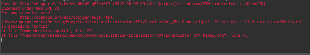

I cannot debug stm32mp157-dk2 on macOS (stm32cubeide). I have those logs in the console:
0693W00000WIig5QAD.pngDoes anyone know how to resolve it? :)
DPery
Copied stm32mp1x.cfg file from windows and now it is working
