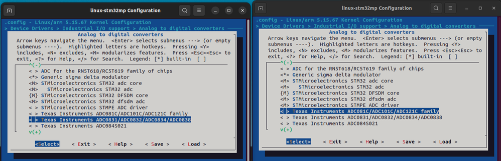

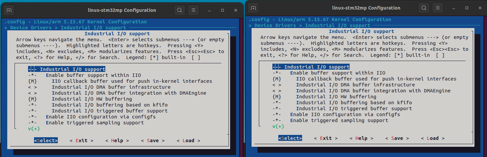

MWoło.2
Senior III
OK,
let's compare
after issue
grep -H "" /sys/bus/iio/devices/*/name | grep adc
I get on my board
grep: /sys/bus/iio/devices/*/name: No such file or directory
and on disco
/sys/bus/iio/devices/iio:device0/name:48003000.adc:adc@0
What do the above means? If I get "No such file ...." it means not configured something in the kernel config or missing something in dts?
MWoło.2
Senior III
The configuration of both board

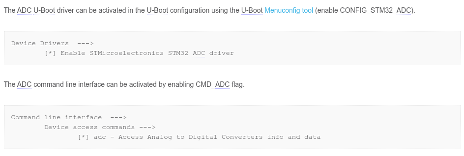

0693W00000aJDsSQAW.png0693W00000aJDrKQAW.pngI can't find only the U-Boot drivers
0693W00000aJDusQAG.pngDo U-Boot configuration (dts+driver) significant?
