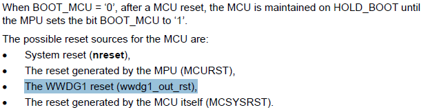

Hello. We are trying to reset MCU from within MCU by asserting SYSRESETREQ it in Cortex M4 AIRCR register (by calling NVIC_SystemReset). After that the MCU halts and FW is not running.
dimax
Senior
If we emulate the MCU watchdog reset on STM32MP1 it works fine. MCU is got restarted and runs after that.
SYSRESETREQ assertion (by calling NVIC_SystemReset) works fine with dedicated M4 processor.
We wander what can be a problem on STM32MP1 ?

AntonioST
Maybe related to the RCC register RCC_MP_GCR ?
If the bit BOOT_MCU is zero, the M4 will not boot after a reset
dimax
Senior
Yes it helped. Thanks.
But as usual your manual is wrong and incomplete. It states the WWDG1 reset is hold by the BOOT_MCU=0, but it does not.

@AntonioST​  I need the M4 to reset when I call NVIC_SystemReset. I don't know how to set the RCC_MP_GCR BOOT_MCU bit from the Linux side of things, and the manual says it cannot be set by the MCU, so how do I set it? I am not seeing anything in that article that explains how to do that, but I could be missing it. Any advice?
Linux is supposed to be the master of the M4, so it's Linux that has to restart the M4.
The easier way I can imagine to let M4 trigger a self-reset is that M4 enables the watchdog and does not refresh it. The watchdog will reset the M4 and send an interrupt to Linux. If the "recovery" flag explained below is set, Linux will restart the M4 firmware.
