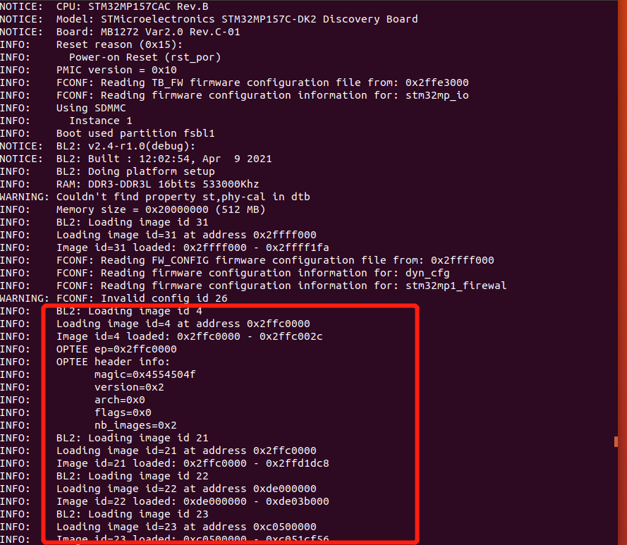

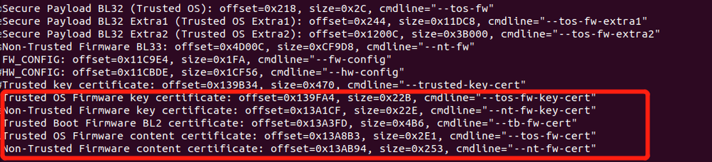

0693W000008z8DCQAY.png0693W000008z8BpQAI.pngYes,I used the latest official version(2021-03-31) to configure the stm32mp157c-dk2 of the optee version, and used the official tutorial to generate fip.bin and burn it to the corresponding partition, but it seems that the image is not checked,in other worlds, I did not see the successful prompt for the verification of the mirror image.
