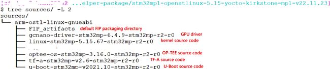

b. Unzip it and Access the Source Folder:
c. Source Code Preparation (can be prepared according to the third point in README.HOW_TO.txt in each source folder):
  • TFA Source Code
$> cd tf-a-stm32mp-v2.6-stm32mp-r2-r0
$> tar xf tf-a-stm32mp-v2.6-stm32mp-r2-r0.tar.xz
$> for p in `ls -1 ../*.patch`; do patch -p1 < $p; done
  • OP-TEE Source Code
$> cd optee-os-stm32mp-3.16.0-stm32mp-r2-r0
$> tar xf optee-os-stm32mp-3.16.0-stm32mp-r2-r0.tar.xz
$> tar xf ../fonts.tar.gz
  • U-Boot Source Code
$> cd u-boot-stm32mp-v2021.10-stm32mp-r2-r0
$> tar xf u-boot-stm32mp-v2021.10-stm32mp-r2-r0.tar.xz
  • Kernel Source Code
$> cd linux-stm32mp-5.15.67-stm32mp-r2-r0
$> tar xf linux-5.15.67.tar.xz
$> cd linux-5.15.67

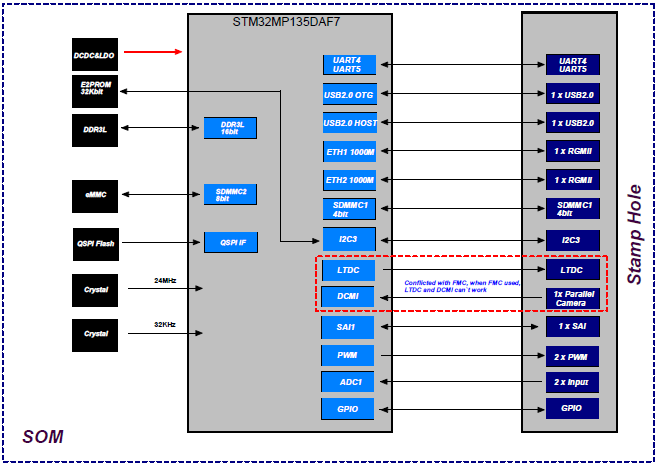

2. Block Diagram
First please review MYIR's schematic framework:
The following hardware configuration information can be derived from the block diagram:
1. STM32MP135DAF7
2. DDR3L
3. Separate power supply design
4. Support QSPI NAND, SD card boot
5. Dual Gigabit Ethernet ports
6. USB Host
7. USB OTG (for burning)
8. UART4 debug serial port
9. External Clock Source, HSE (24MHz), LSE (32.768KHz)

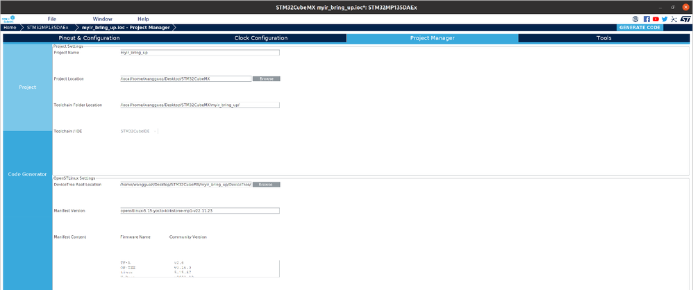

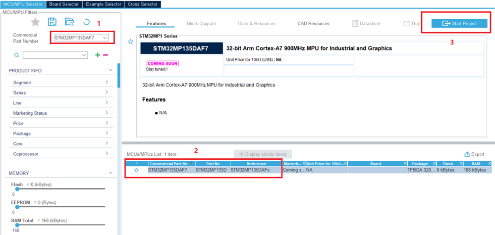

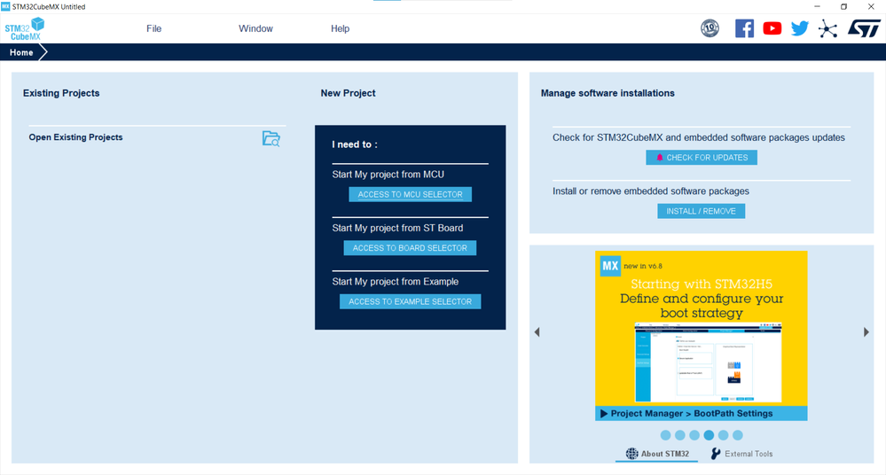

3. STM32CubeMX Project Creation
Open STM32CubeMX, select the correct chip package according to the chip's part number and start the project creation. e.g. MYIR uses STM32MP135DAF7.

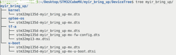

Clicking "Generate Code" will create a nearly empty project, the device tree structure:
NOTE: The rule for STM32CubeMX is to build the Kernel dts first, then copy the generated dts file to the u-boot folder. In other words, the device tree of u-boot stm32mp135d-myir_bring_up-mx.dts is copied from the Kernel directory, so when you modify the device tree and add User code in U-Boot stage, please modify the device tree of Kernel synchronously, or copy the modified device tree to the Kernel directory. This will prevent the modification of the u-boot part from being overwritten by the unmodified device tree of the kernel when CubeMX builds the device tree next time.
Creates the device tree link:
  • TFA
PC $> cd
PC $> ln -s /local/home/xxx/Desktop/STM32CubeMX/myir_bring_up/DeviceTree/myir_bring_up/tf-a/* fdts/
  • OP-TEE:
PC $> cd
PC $> ln  -s /local/home/xxx/Desktop/STM32CubeMX/myir_bring_up/DeviceTree/myir_bring_up/optee-os/* core/arch/arm/dts/
  • U-Boot:
PC $> cd
PC $> ln  -s /local/home/xxx/Desktop/STM32CubeMX/myir_bring_up/DeviceTree/myir_bring_up/u-boot/* arch/arm/dts/
