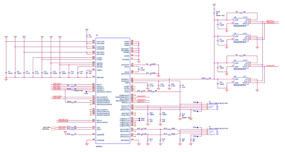

Hi All,
i'm having an issue with STM32MP157c and audio driver WM8994 (same as used into STM32MP15-DK).
At boot time i'm still have the following error:
[ 4.250237] ALSA device list:
[ 4.251761] No soundcards found.
I share the electrical drawing of our custom board and my custom DTS.
I followed the steps described here:
https://wiki.st.com/stm32mpu/wiki/Soundcard_configuration#References
but i'm still get the same error.
Kind regards
Ilie

‎2021-10-29 12:33 AM
Hi @IDe P.1​ ,
WM8994 is used on EV1 board not DK ( which use CS42L51 ).
Also, I notice you are using for your design a DTS based on EV1 ..
compatible = "st,stm32mp157c-ev1", "st,stm32mp157c-ed1", "st,stm32mp157";
This looks consistent since your design seems to be very close to EV1 ..
But you use "sound" node template from DK ..
sound {
compatible = "audio-graph-card";
label = "STM32MP15-DK"; /* Sound card identified as STM32MP15DK in ALSA */
routing =
"Playback" , "MCLK1",
"Capture" , "MCLK1",
"MICL" , "Mic Bias";
dais = <&sai2a_port &sai2b_port>;
status = "okay";
I guess it would be better to stick on EV1 model :
sound {
label = "STM32MP15-EV";
routing =
"AIF1CLK" , "MCLK1",
"AIF2CLK" , "MCLK1",
"IN1LN" , "MICBIAS2",
"DMIC2DAT" , "MICBIAS1",
"DMIC1DAT" , "MICBIAS1";
dais = <&sai2a_port &sai2b_port &sai4a_port &spdifrx_port
&dfsdm0_port &dfsdm1_port &dfsdm2_port &dfsdm3_port>;
status = "okay";
Hope it help
Olivier
