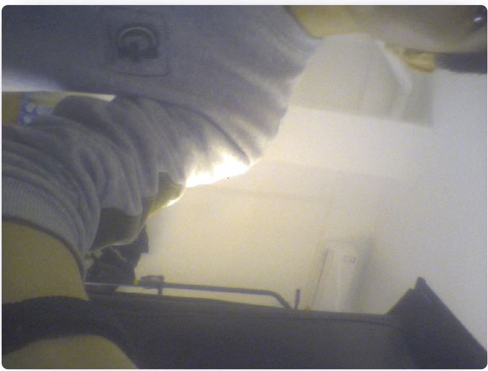

I'm working on camera integration with GC05A2 on STM32MP257. The raw image quality is acceptable, but after enabling AWB and CCM in the ISP pipeline, the output image shows severe noise (both luminance and color noise), especially in low-light conditions (<300 Lux) or shadow areas.
Questions:
Where is the noise reduction? Does STM32MP257 ISP have built-in hardware noise reduction (2D/3D NR)? If yes, how do I enable and control it through V4L2 or the driver?53786dcf-8fc2-4275-8466-6fc329568b10.jpg

according to RM0547, I did not see any noise reduction inside the ISP.
ISP HW is stated to be a lite one, mostly intended to image analysis (e.g. AI image processing).
"Mid quality conversion for display and software analysis purposes (high quality conversion can be done in software upon trigger, for still-image only)"
Regards.
