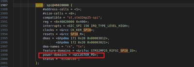

I am currently using the distribution version:
V5、rt 6.1.82-rt patch、stm32mp257
Currently, the SPI interface is bound by default power-domains;
I don't want the SPI interface to enter sleep mode during idle time, as it may cause Oops issues
1.How can I prevent it from entering the regulation of this power domain? Do you want to directly delete power domains in the device tree?
2.Once power domains are deleted, will SPI peripherals not enter power consumption adjustment? Or is it in an unknown state?

hello,Christophe:
When I integrate the SPI-to-CAN chip (MCP2518fd) on the STM32MP257 to expand CAN communication, the following Oops occurs:
I use version:V5、rt 6.1.82-rt patch、stm32mp257
Native CAN communication does not have this issue, so it is preliminarily identified that the problem is caused by the incompatibility of SPI power management under the real-time patch.
I have removed the power domain corresponding to the SPI device tree these days, and this problem will not exist.
But I don't know the specific reason, whether there are other hidden dangers, and whether ST support is needed.
