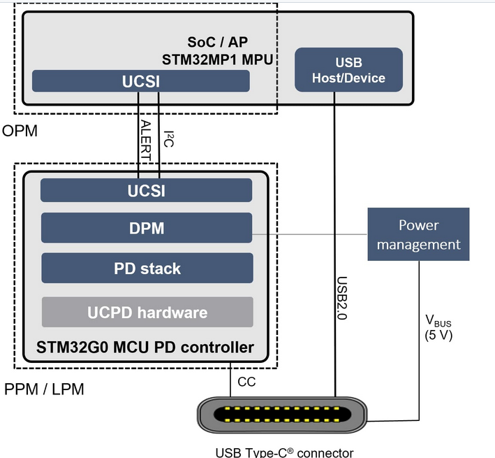

What is the role of UCSI Operating Policy Manager (OPM) in STM32MP1 series microprocessors?

Currently, I'm using X-CUBE-UCSI and came across some information in the user manual regarding the UCSI Operating Policy Manager (OPM) functionality in STM32MP1 series microprocessors. I was wondering if anyone could point me in the right direction to find open resources or documentation related to this topic. Any help would be greatly appreciated.

Hi @kyle Sun​
Maybe have a look to
https://github.com/STMicroelectronics/x-cube-ucsi
and associated documents.
I'm not expert, but I assume you could also find all information related to the standard on https://www.usb.org/document-library/usb-type-cr-connector-system-software-interface-ucsi-specification
Btw, some terms:
OPM : OS Policy Manager. Operating Software that interfaces with the PPM.
PPM : Platform Policy Manager. Hardware/firmware that manages all the USB Type-C connectors on the platform.
LPM : Local Policy Manager. Hardware/firmware that manages an individual USB Type-C connector.
Regards.

Regarding the x-cube-ucsi and UCSI specification documents you mentioned, I designed my device based on these two documents. However, after I finished designing it, I'm not sure if it complies with the standards. I don't have an OPM to test it.
