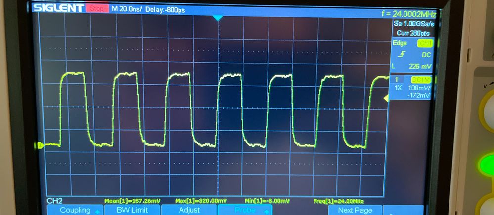

I have a custom board I made with the STM32MP1 and I seemed to have royally messed up the clock circuit. I have an ASDMB-24.000MHZ-LC-T clock chip generating a square wave clock but HSE_OUT is being pulled high which puts the STM32MP1 into analog-bypass mode. The chip does not seem to be booting to the point where I can access USB or UART DFU mode. UART lines are both low and I would expect the TX line to be high until a start bit is sent. I am assuming this is because the chip is not getting clocked properly. Looking to the experts to tell me if this really is the case or if I am chasing a red herring and it should work OK on analog-bypass with a square wave clock. I have attached a photo of the clock signal, best I have right now but I can get a better one later if it's required.
I plan on attempting to perform some board surgery to cut the trace pulling the HSE_OUT high and tie it low but was looking for some input before I go do that.
PA13 is low as well which I would expect to be pulsing at 5HZ waiting for USB/UART DFU.

Maybe the tr/tf of your signal is to fast, see table 30 tr/tf(HSE) in the datasheet. Can you put a resistor in the HSE_IN line so that tr/tf gets slower?
Thanks for the suggestion! I compared my clock signal to the one on the DK2 board and they are nearly identical. I will double check the tr/tf numbers this evening though.
The only difference that I can tell is coming from the HSE_OUT being pulled high on my board, setting the processor to analog bypass mode.

This post was very helpful. I did not realize that the PA13 is open drain, nor did I realize the UART lines wont become active. I put the board into USB/DFU mode by setting the boot pins to 0b000 and put a pull-up on PA13 and it started toggling! Cube Programmer can now talk to the board which must mean it's clocking despite being set to analog bypass mode. Great news! Going to get a uboot build complete and then try the DRAM test out.
Thanks for all the help!
