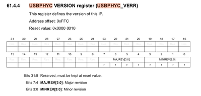

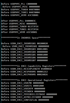

I am working on a custom board based on STM32MP157A and I am getting all the bits correctly but getting values at reserved bits in USBPHYC version register (Internal) which are supposed to be reserved  as per the reference manual.
Below mentioned screenshots contains :
1.Register from reference manual:
2.Below attached image contains values I am getting when reading the register:
And I am confused on how to move forward with usbphy.I hope someone could help me with the problem

HI @Srikanth1
you are right, there is a mistake in the offset of this register in the reference manual. Correct offset is 0x3F4
Thanks to pointing this issue, will be corrected in a future revision of the document.

            Thanks for the reply,now we could read the register correctly.And as of now I am stuck on how to move forward and what can be the next step to be done.

Btw, I will correct my first answer as USBPHYC_VERR register offset if 0x3F4 (0xFF4 is true, but is a mirroring view). Will be corrected as well in RM0475.
