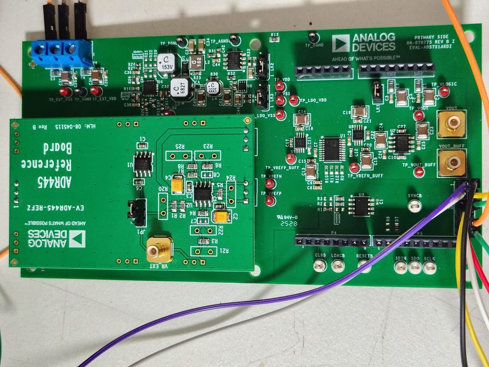

I am trying to interface EVAL-AD5791ARDZ DAC board with STM32MP257F-EV1 using SPI3 from A35 Linux.
Hardware used
  • STM32MP257F-EV1
  • EVAL-AD5791ARDZ
  • EV-ADR445-REFZ reference daughter board
  • External dual power supply for analog rails
Digital PMOD connections
STM32MP257F-EV1 pin 24 / PB1  / SPI3_NSS   -> AD5791 PMOD 1 / SYNCB
STM32MP257F-EV1 pin 19 / PB8  / SPI3_MOSI  -> AD5791 PMOD 2 / SDIN
STM32MP257F-EV1 pin 21 / PB10 / SPI3_MISO  -> AD5791 PMOD 3 / SDO
STM32MP257F-EV1 pin 23 / PB7  / SPI3_SCK   -> AD5791 PMOD 4 / SCLK
STM32MP257F-EV1 3V3 -> AD5791 PMOD 6 / VLOGIC
STM32MP257F-EV1 GND -> AD5791 PMOD 5 / DGND
LDAC  -> GND
RESET -> 3.3 V
CLR   -> 3.3 V

Measured output examples:
0x00000 = 0 V
0x80000 = 0.20 V
0xFFFFF = 0.20 V
Sometimes I saw around 2.2 V, but output is not following the DAC code correctly.
Power measurements
Digital/control side looks correct:
VLOGIC to DGND = 3.3 V
RESET to DGND  = 3.3 V
CLR to DGND    = 3.3 V
LDAC to DGND   = 0 V
Analog supply rails are present:
VDD to AGND = +12 V / +15 V
VSS to AGND = -12 V / -15 V
But the reference voltages are wrong:
VREFP to AGND = about 0.80 V
VREFN to AGND = about 0.74 V
Also, the ADR445 reference daughter board does not seem to generate the expected 5 V reference. I checked the 5 V test point and it is not showing 5 V.
Current suspicion
The issue seems not to be STM32 SPI now, but the EVAL-AD5791ARDZ reference board / reference power path.
The EV-ADR445-REFZ daughter board is physically plugged into the EVAL-AD5791ARDZ board, but the AD5791 board is not getting proper reference voltages.
Questions
  1. On EVAL-AD5791ARDZ, what jumper/link settings are required for using the EV-ADR445-REFZ reference board?
  2. Should the ADR445 reference board automatically generate VREFP/VREFN when VDD/VSS are applied?
  3. Which test points should show 5 V, +10 V, and -10 V?
  4. Is ±12 V enough for generating ±10 V reference, or should I use ±15 V?
  5. Are there any required links/jumpers near LK2, LK3, LK4, or LK12 for enabling the reference path?
I have attached a photo of my EVAL-AD5791ARDZ + EV-ADR445-REFZ setup.WhatsApp Image 2026-05-27 at 1.13.44 PM.jpeg
Main issue: AD5791 VDD/VSS are correct, but VREFP/VREFN stay around 0.8 V and ADR445 5 V TP is not coming up.
