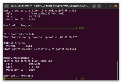

I am reaching out regarding an issue we've encountered while attempting to flash our Buildroot image using the STM32CubeProgrammer in DFU mode.
Despite successfully building the image with Buildroot, we are encountering difficulties when attempting to flash it. Specifically, the STM32CubeProgrammer fails to recognize the image properly, displaying incorrect file size information, and subsequently failing after some time.

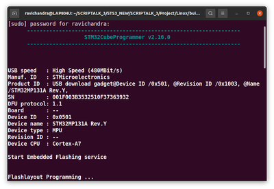

could you please precise more your environment :
  • PC Linux or Windows ? OS version ?
  • could you share your TSV file ?
  • any message on the console ?
  • CubeProgrammer version ?
  • OpenSTLinux ecosystem version ?

We are using Linux (Ubuntu 20.04.6 LTS) and Buildroot as our Build environment
CubeProgrammer - STM32CubeProgrammer v2.14.0
OpenSTLinux ecosystem - STM32MPU-ecosystem-v5.0.0(v6.1-stm32mp-r1)

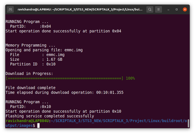

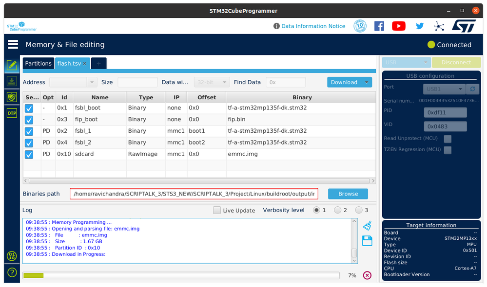

We are not seeing any errors in console, but the CubeProgrammer is not detecting the file size properly, the actual image size is around ~6GB but it will be listed as 1.67 GB. After programming if we are trying to boot the device we will end up with kernel panic.
Please find the attached TSV file
Hi @ravichandra_t
please try with latest Cubeprogrammer (v2.16.0)

Hi @PatrickF
Same with CubeProgrammer(v2.16.0) also, it is detecting as 1.67GB

does CubeProgrammer v2.16.0 flash correctly ?
I think the file size issue is only a display issue.

ravichandra_t
Hi @PatrickF,
No Luck with CubeProgrammer v2.16.0 as well
