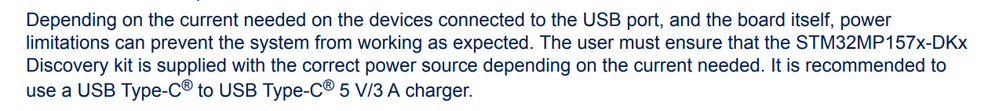

I think , the user manual states it very clear :

And use a power supply , that only (!) can do 5V , 3A . As written in manual.
NOT guessing, it should be do this or that...
And i admit, using the USB-C is in some way seductive , to think, it works like an I-Phone and has high power SMPS inside. But think, this is not a product for the mass market, its for engineers and developers, so the producer can expect, they read, what it can do and what is not allowed.
