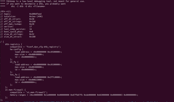

Custom STM32MP157AAA3 board with 512MB DDR.
[Note: the NOTICE: DEBUG messages in below logs were added to the source code of TF-A]
The TF-A DT was compiled with option for SYSRAM with resulting dtb fw-config
OP-TEE was compiled for SYSRAM and and enabled with pager as can be seen in  the contents FIP file:
The reservation was made in OP-TEE DT:
The optee-header_v2.bin: file  generated:
Result:

WARNING: The load address in optee header 0x2ffc0000 - 0x2ffe6fc0 is not in reserved area: 0x2ffc0000 - 0x2ffe2000.
ERROR: OPTEE header parse error.
PANIC at PC : 0x2ffed03d

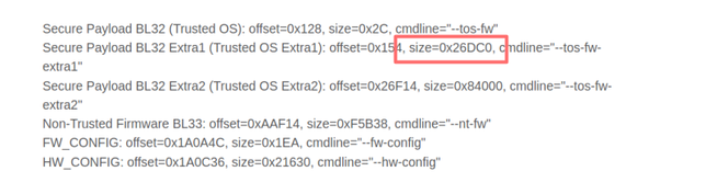

The OP-TEE generated header file optee-header_v2.bin has the load address for FW_CONFIG (image ID 1) set to 0x2FFC0000,  that is the same address that OPTEE tries to load loading Image ID  #8 (extra 1) , also the boot log below. Changed the starting address in the OPTEE , conf.mk file to 0x2FFC0200 to avoid a conflict. (shown in the picture below) The optee-header_v2.bin has the size set to 0x26dc0 which is the size of BL32 Extra 1  (ID 8) this isis too large to load in SRAM and created an BL2 load error as above.
After changing the size in the OP-TEE .mk file to to 0x1000 the OPTEE build still set it to 0x26EC0 in the header.:
It seems the OPTEE build  ignored the config.mk file setting

1 Why does OPTEE use the same start address for image ID 8 (Extra 1) and for ID 1 (FWCONFIG) ? Is this correct ? If we had not changed the base address in the conf.mk to 0x2ffc000200 it would start to overwrite FWCONFIG data at 0x2ffc0000 with ID8  BL32,  OP-TEE extra 1, data
2. Why does OPTEE set a larger size in the header for BL32 extra 1 than available in SRAM for OT-TEE ?
3. and why does OPTEE ignore the CFG_TSZR_RAM size setting t(to reduce the size for SYSRAM) in the conf.mk file ?
4. Where does BL2 get the base address 0xde000000 and size from (see log below) ?
5. Is 0xde000000 the address BL2 will try to load image ID#9 (BL32 Extra 2) ?
6. What is/could be wrong ?
