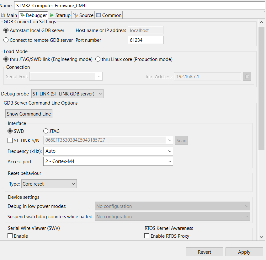

Software:
I have configure the Software Debug pins.
And the debug settings.

Even if I remove the cables that connect my ST-LINK V2 to the home made STM32MP1 board. I still get the same issue. So it seems that I don't have any connection, rather than NRST, VCC, GND, UART, USB etc.
So it cannot be bad soldering, and it cannot be bad PCB routing. So what can it be then? It must be a software issue? Right?

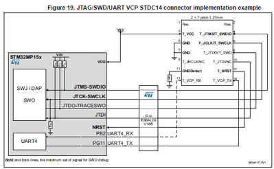

HI @DMårt
few clarifications
- STLINK is only for debug purpose (so should connect to at least SWD pins SWDIO and SWCLK and GND/VDD, you did not mention those ones)
- To use ST-Link to debug Cortex-M4 FW, you must be either
  - in production mode (i.e. Linux up and running from flash and M4 FW loaded thru USB SSH by CubeIDE). this is described in https://wiki.st.com/stm32mpu/wiki/Getting_started/STM32MP1_boards/STM32MP157x-EV1/Develop_on_Arm%C2%AE_Cortex%C2%AE-M4/Modify,_rebuild_and_reload_a_firmware
  - in development boot (aka engineering boot), using BOOT[2:0] = 0b100
See https://wiki.st.com/stm32mpu/wiki/STM32CubeIDE#Arm-C2-AE_Cortex-C2-AE-M_debug_on_STM32_MPU_device
Regards.
