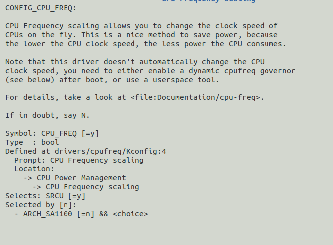

is there any way find dts config /sys/ file to check stm32mp1  in linux sdk ?
cpu temp
freq
battery voltage vbat measurement.

I don't know why, but it seems that these kernel configs are missing in your configuration.
CONFIG_CPU_FREQ=y
CONFIG_CPU_FREQ_STAT=y
CONFIG_CPU_FREQ_DEFAULT_GOV_ONDEMAND=y
CONFIG_CPU_FREQ_GOV_POWERSAVE=m
CONFIG_CPU_FREQ_GOV_USERSPACE=m
CONFIG_CPU_FREQ_GOV_CONSERVATIVE=m
CONFIG_CPU_FREQ_GOV_SCHEDUTIL=y
CONFIG_CPUFREQ_DT=y
Please add them by enabling:
If you are using the starter package, they are already enabled, but for testing purpose, I removed these configurations from my linux on my MP157f-dk2 with the starter package and I get the same issue than you.
root@stm32mp1:~# cat /sys/devices/system/cpu/cpu0/cpufreq/cpuinfo_cur_freq
cat: /sys/devices/system/cpu/cpu0/cpufreq/cpuinfo_cur_freq: No such file or directory
Please have a look at this page if you don't know how to modify your linux configuration: https://wiki.st.com/stm32mpu/wiki/Menuconfig_or_how_to_configure_kernel
PS: If you built your kernel in a different build directory (different of kernel source code directory), remember to specify it when using the make command of the wiki page.
Hope it helps,

Hi Patric,
Temperature info got it
but CPU cat /sys/devices/system/cpu/cpu0/cpufreq/cpuinfo_cur_freq is not there
for cpu freq any dts change required?
Tested ok on my side with both Ecosystem V3 (kernel 5.10) and Ecosystem V2 (kernel 5.4) using Starter Package on both STM32MP157F-DK2 and STM32MP157C-DK2 boards.
Maybe missing the &cpu0_opp_table, even if fixed frequency on your board (although obviously useless to check the frequency if it is fixed).
see https://wiki.st.com/stm32mpu/wiki/How_to_change_the_CPU_frequency#OPP_table
