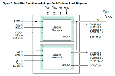

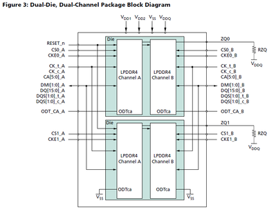

For example: The MP257-DK is validated with MT53E1G32D2FW-046 WT:C, but that DRAM is out of stock. Could I use MT53E1G32D2FW-046 WT:B instead? It's the design B version instead of design C version.

The major thing to look for is that it should be a single rank memory.
For LPDDR4 (i.e. single CS per channel), it is not always clear inside memory datasheets.
For DDR3L or DDR4 (should be single rank as well), it is simpler, and all JEDEC x16 with frequency above respectively 1066 and 1200 MHz should  work.
See also
Looking at the references you mention, the revision B (Z42M) is NOT single rank (look at CS1_A and CS1_B)
While the revision C (Z42N) is single rank. So ok for STM32MP2.
