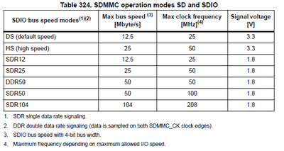

First the MP2 reads the SD Card. Then the clock signal turns from square wave to incredible fast sine wave.
What I think is the BootROM ask the SD card what typ of SD card it is. Then the SD card introduce itself as UHS-I and the MP2 turn up the speed.
The problem is that my pull up is 3.3V from LDO2. I need to tell the MP2 or the SD card to talk in lower speed. Is that possible?
Or if I already know the speed of my SD UHS-I card. Can I have 1.8V as the initial pull up?

So, you mean that the MP257 is reading the DT?
No, in my TF-a DT, i haven't remove the UHS-I speed. I'm planning to do it.
So it's possible to run UHS-I SD card in slow mode e.g fixed VDDIO_SDCARD = 3.3V?
If yes, well. That must be the answer of this question.

Hi @DMårt
SD-Card always start @3.3V 400kHz, then Host get Card capabilities (voltage, frequencies) to decide to change that later (BootROM keep 3.3V but go to 16MHz after very first card query).
I don't know if it is TF-A or uBoot which speed up to UHS-I (while going to 1.8V for IOs, but Card supply is always 3.3V).
Regards.
