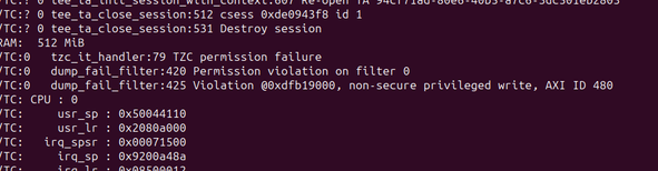

Just got the same error in a  512MB board. How to fix this ?
OP-TEE DT:
memory@c0000000 {
device_type = "memory";
reg = <0xc0000000 0x20000000>;
/* USER CODE BEGIN memory */
/* USER CODE END memory */
reserved-memory {
#address-cells = <1>;
#size-cells = <1>;
ranges;
/* USER CODE BEGIN reserved-memory */
optee_framebuffer: optee-framebuffer@dd000000 {
/* Secure framebuffer memory */
reg = <0xdd000000 0x1000000>;
st,protreg = <TZC_REGION_S_RDWR 0>;
/* USER CODE END reserved-memory */
and U-boot:
memory@c0000000 {
reserved-memory {
#size-cells = <1>;
ranges;
reserved-memory {
#size-cells = <1>;
ranges;
optee_framebuffer@dd000000 {
no-map;
optee@de000000 {
reg = <0xde000000 0x02000000>;
no-map;
 0xDD0000000 was used as posted in the below WIKI , assuming that is the area  to be used for 512MB
Though, This WIKI is for  STM32MP135. There is no WIKI version for STM32MP15 (in my case 512MB) or any information ho to configure this for different CPU and memory configurations.
https://wiki.st.com/stm32mpu/index.php?title=How_to_configure_a_256MB_DDR_mapping_from_STM32_MPU_Distribution_Package

Gregory PLANCHON
can you check your U-boot device tree to see if you have the following name?
If not, you can add it and this should normally correct the error.
reserved-memory {
                optee@de000000 {
                        reg = <0xde000000 0x2000000>;
                        no-map;

@Gregory PLANCHON
it is as in my previous post above,
MY boot log shows NOTICE: BL2: Booting BL32
INFO: Entry point address = 0x2ffc0000
but I read it should be 0xDE000000. I do not know why mine is different,  Here is my post, we could continue there as this tread should be closed by the original OP.
https://community.st.com/t5/stm32-mpus-products/stm32mp15-eco-5-0-0-optee-in-sysram-non-secure-privileged-write/td-p/591438
reserved-memory {
#size-cells = <1>;
ranges;
reserved-memory {
#size-cells = <1>;
ranges;
reg = <0xdd000000 0x01000000>;
no-map;
optee@de000000 {
no-map;
I am working on STM32MP151a, ST ecosystem v5, openstlinux-6.1-yocto-mickledore-mp1-v23.06.21.
I faced the same issue.  When flashing my board.
I also solved adding the below nodes to u-boot.xxx.dts file
	memory@c0000000 {
	reserved-memory {
		#size-cells = <1>;
		ranges;
		optee@de000000 {
			no-map;
