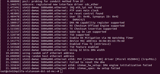

It seems that I have a problem with DMA, but I'm not sure. Would you please take a look at the below screen
0693W00000FDX7aQAH.pngDts looks
0693W00000FDX7zQAH.jpg0693W00000FDX84QAH.jpgI intend to achieve MII with self-generated quartz.
Unfortunately, I'm stuck on this "Failed to reset the DMA".

the message 'failed to reset the DMA' come usually from a missing clock on the GMAC (usually a clock from the PHY) which avoid the driver to correctly initialize the GMAC (ETH IP).
Please check the RefMan RCC "Clock distribution for Ethernet (ETH)".

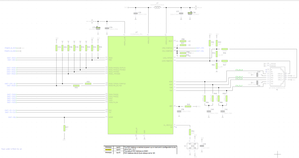

Hi Patrick,
I have self-generated quartz. I check using an oscilloscope and sine waveform exist on pin XI/REFCLK equals 25MHz.
Regarding RMII I need to use 50MHz? I decided to use MII, but if for some reason it is a problem I can change it in the next revision. If RMII can work on 25MHz I need to change just one resistor on PCB.

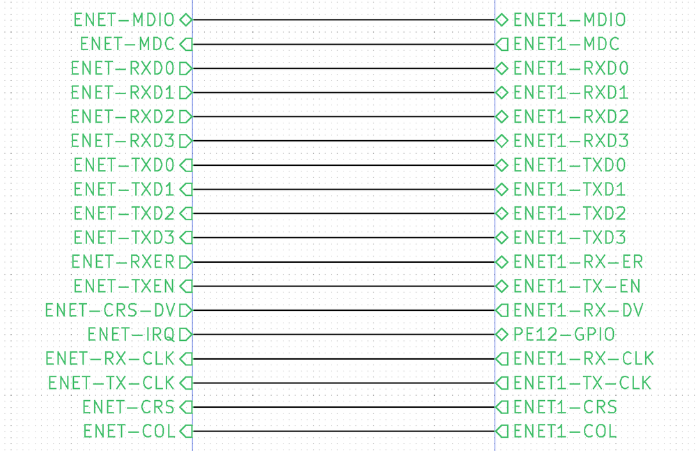

Below parts of my schematic
0693W00000FDhq1QAD.pngand

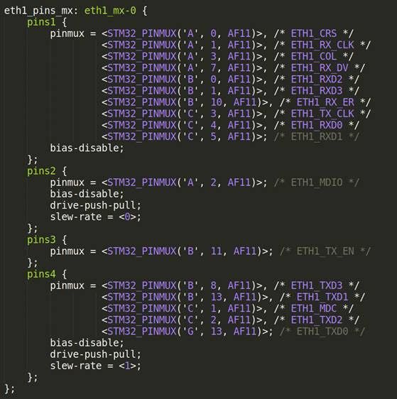

0693W00000FDhq6QAD.pngConnections generated from CubeMX.
In my current project, ETH_CLK is used as SPI1_MOSI and as ENET1-RX-CLK
0693W00000FDhqBQAT.png0693W00000FDhqVQAT.pngUnfortunately on

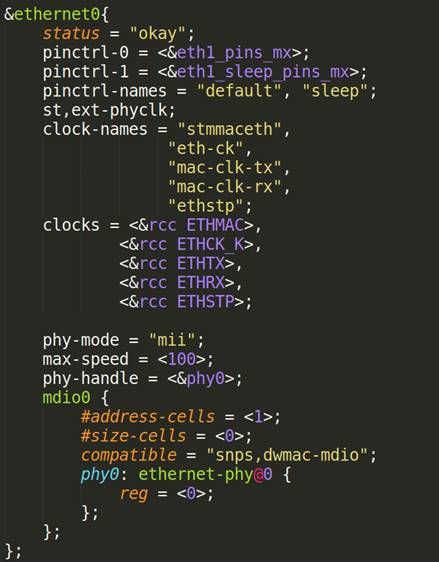

please try to remove the
st,ext-phyclk;

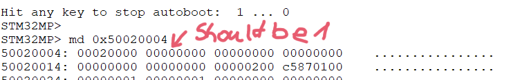

If it does not work after this change, please check the SYSCFG_PMCSETR register, by using either:
  • uBoot: md 0x50020004
  • Linux: devmem2 0x50020004 W (need to install devmem2 on the target which might be an issue without network)
field ETH_SEL should be 0b000
field ETH_SELMII should be 1
field ETH_REF_CLK_SEL should be 0
Regards

The result has been taken after stopped U-Boot execution. Of course, remove st,ext-phyclk; from U-Boot dts and Kernel dts.
0693W00000FDpqdQAD.pngAnd similar in the Kernel
0693W00000FDqHAQA1.pngHow to set this bit. Do I miss something in dts, or maybe this is still a hardware issue?
PatrickF
according to uBoot dump, seems the value at 0x50020004 is 0x0020000, which could be explained by st,ext-phyclk;
Please check you are really using the expected DT.
Maybe share complete DT and uBoot + Linux log files.
please check you have st,syscon = <&syscfg 0x4>;
It should be present by default in ethernet0 node from the included stm32mp151.dtsi file during DT compilation
