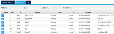

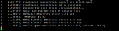

I have a custom board (with eMMC) that freezes in the middle of kernel loading:
I am under the impression it is related with the rootfs.ext4, becuase it does not try the loading, but I am not sure yet.
Flash table is the following (I don´t use all the rest of partitions):
Is there any way I can debug or any way to understand what is going on?
Thank you in advance.
Flyback
Just in case somebody has the same issue, I was not pointing to the right partition in rootfs in extlinux.conf.
