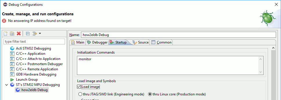

I use jtag debugging m4 program, the following error, how should be resolved

AntonioST
Your message does not explain the environment you are using, so I try to guess it.

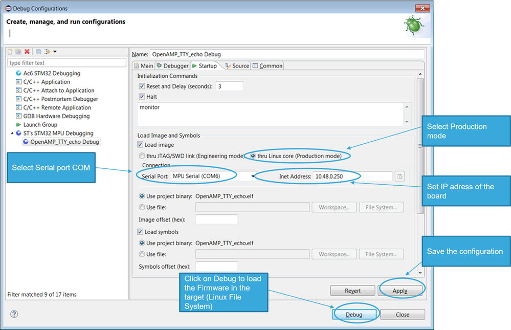

I believe you are running SystemWorkbench while on the STM32MP1 is running Linux
In this configuration, you cannot load the M4 firmware through JTAG/SWD, but you need to "ask" Linux on the board to load the FW on M4,
This is done through "Debug Configuration" in SystemWorkbench. See screenshot below
Please also notice that SystemWorkbench is currently obsoleted.
I suggest you to switch to CubeIDE, available on ST website

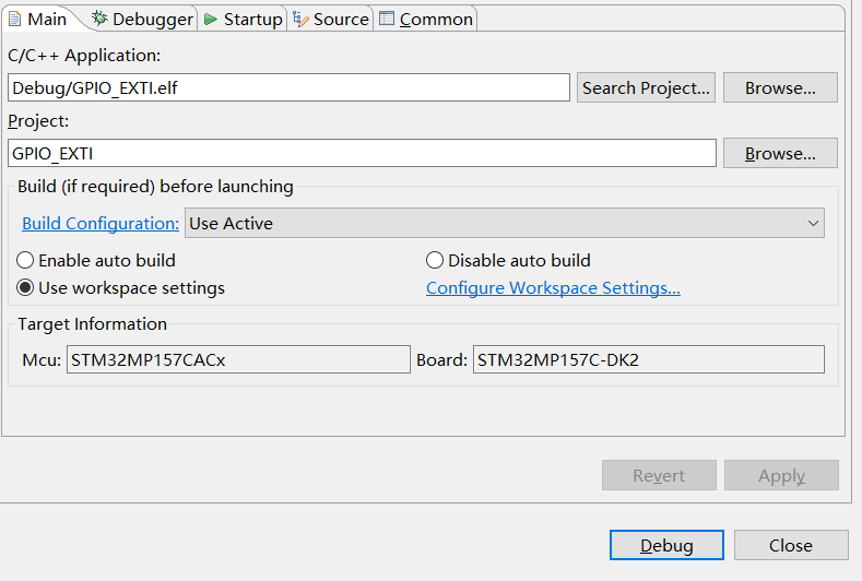

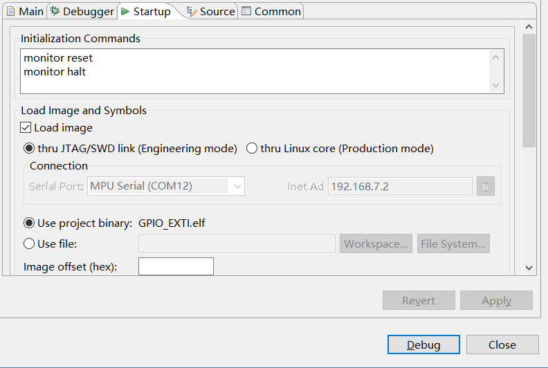

  • Thanks for your reply, please help to check my configuration

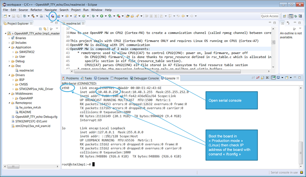

I'm reviewing "https://wiki.st.com/stm32mpu/wiki/STM32CubeMP1_Package" site and follow the step.
It says input eth0 ip address like as below.
and need to input like as below

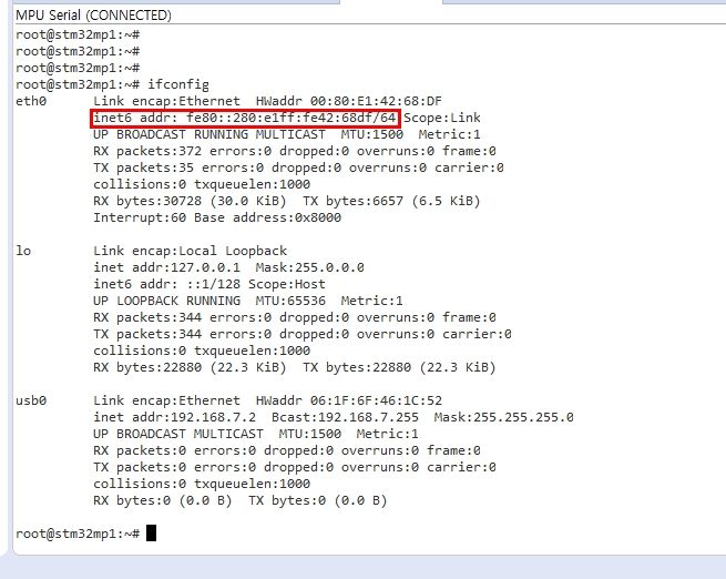

My case is like as below.
my case, I cannot find inet4 addr and have inet6 addr.
So cannot use inet6 addr to /Startup/inet addr.
I have connected usb c cable with my laptop so also usb0 interface has inet addr so I put this addr at "/Startup/inet addr" and failed to work.
How can I get inet4 addr at eth0?
Is it due to usb connection or other issue?
Thank you. My problem has been solved.The problem is that engineering mode is not set
