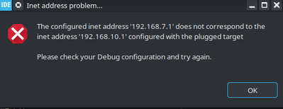

  2. The Debugger resolve wrongly IP of the board:
    We have pppd interface in the Linux. The debugger wrongly detects it's IP as the debugger IP.
    It results with this error:

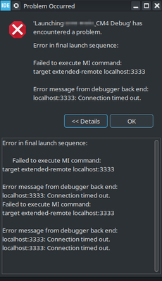

    I'm also getting this error in console, it looks like the script/commands are interpreted wrongly:
  3. I'm still not able to get the ST-Link to work. It always ends with this error:

I was finally able to get the st-link debugger to work on a custom board. What I found, SWO pin is also needed (I had connected only SW data and clock).
I also had to add manual routing to my notebook to be able to work with the wrong IP address (I didn't find any way how to fix this, it's obvious bug in the debugger).
