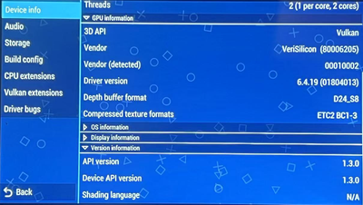

Then I tried switching to Vulkan. At first, the emulator crashed on startup. I debugged it by adding some print statements and found that a function call was returning an incorrect value – which shouldn't happen according to the Vulkan spec. Because of that, another function (vkCreateSwapchainKHR) ended up failing.

    I found that the values of surfCapabilities_.maxImageExtent.width and .height were both -1(max: -1x-1 computed: -1x-1 ), which does not conform to the Vulkan standard, and Vulkan simply couldn't work. So I forcibly modified both values to 4096 (the current resolution being used is 1270x720), and then the Vulkan driver was able to run.
    Vulkan started up properly, and the frame rate improved a lot – Tekken 6 runs at about 49 FPS now, with CPU usage dropping to 50%.

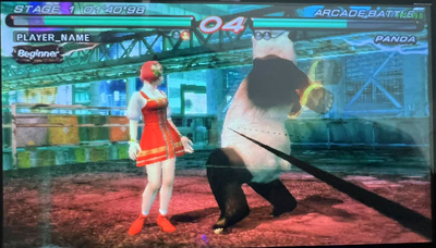

   Now I'm stuck with another issue: screen tearing. It shows up as random radial tears spreading outward from the center of the screen. This didn't happen with GLES. I've tried debugging but no luck. My guess is Vulkan 1.3.3 isn't fully supported on this platform yet. Any way to fix this?
