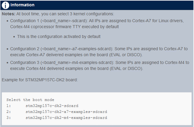

Well, I managed to resolve my "bonus" problem.  Turns out I need to ensure I have the M4 examples mode selected, so I have a few things I need to figure out related to the startup at this point:
1) How do I setup the startup so that it:
a) Selects the M4 Examples option without needing to be prompted
b) Starts up the M4 project on startup (as described above)
2) I need to find out what selecting the 3 different options at startup are actually doing (are they configuring the device tree differently?)  What is it doing differently in the M4 startup from the plain OpenSTLinux?
Any chance someone can point me the right direction where to look to find this info?
PatrickF
yes, starter package allows to choose different device tree for Linux kernel in order to run examples.
https://wiki.st.com/stm32mpu/wiki/STM32CubeMP1_Package#Introduction_to_boot_mode
Regarding Bonus, please have a look to https://wiki.st.com/stm32mpu/wiki/Power_overview#How_to_trace_and_debug
Seems you have DMA2 channel 1 not stopped (need to did to see who is using it).
Did you try using "echo mem > /sys/power/state" instead ?

Thanks for the quick reply!  As per my update post, I managed to get the errors to go away by selecting the M4 examples from the Starter package, which at least gets my program running.
