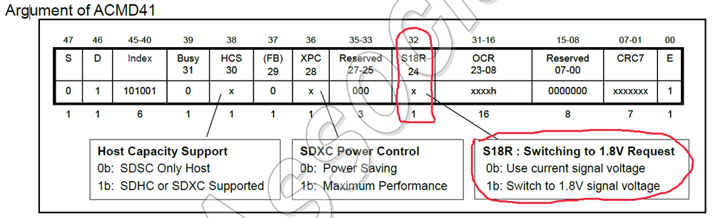

Hi @Eldam and @PatrickF !
I finally found the problem! That was quite tricky! It was the SD card but not as intended in the discussed way...
Shortly: my custom board didn't have the same pmic that the STM32MP157DK2 has (maybe because it's deprecated? I'm not sure). Our pmic (chosen by previous electronic engineers) doesn't implement the DYNAMIC VOLTAGE SWITCHING required by the SDHC (or more modern protocols) at the initialization stage.
E.G.
So when the bootstrap code requires that, it fails!
This was also proved by boot dmesg(s) :
 [    3.663535] mmc0: error -110 whilst initialising SD card
The right solution is to change the pmic and comply with the protocol.
The dirty solution is to use old SD cards, which don't implement the voltage switch (tested OK, they work)
Thanks for the support!
