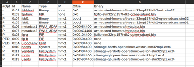

Hi @PatrickF
now in both linux & u-boot my EMMC is detected
you can check the logs , but i try to flash the images on emmc but i got error like mmc 1 not found on STMcubeprogrammer.
I edited the tsv file of 157f-dk2. in place of mmc0 i put the mmc1. but not working. please let me know once where i am missing.
bootpins: (b000) DFU mode.

you are trying to flash the SD-Card binaries into eMMC. You must use the eMMC ones with right TSV.
Please have a look to https://wiki.st.com/stm32mpu/wiki/STM32CubeProgrammer_flashlayout#e-E2-80-A2MMC
Regards.
Tip of the day: Try Sidekick STM32 AI agent, see here
Hi @PatrickF
yes, you are right. right now i am using the stm32mp157f-dk2 image for my custom board. So i found only the sd_card imags (that's why i am using this images ) not the emmc images. so how can i build the emmc image for custom board (stm32mp157f-dk2). or which images should i use for emmc.
I think only some image should be change :-
- 0x03    fip-boot   FIP         none                 fip/fip-stm32mp157f-dk2-optee-sdcard.bin
P 0x04   fsbl1      Binary     mmc0                arm-trusted-firmware/tf-a-stm32mp157f-dk2-optee-sdcard.stm32
P 0x05   fsbl2      Binary     mmc0                arm-trusted-firmware/tf-a-stm32mp157f-dk2-optee-sdcard.stm32
P 0x08 fip-a         FIP         mmc0                 fip/fip-stm32mp157f-dk2-optee-sdcard.bin
i tried to found the emmc images but I didn't get.
custom board mean custom images.
The starter package images provided by ST works only on ST boards with only the Flash available on those boards. There is no eMMC image for STM32MP157F-DK2 as this board only provide SD-Card..
You should create a Device Tree aligned with your board HW and build using Yocto.
Please have a look to following https://wiki.st.com/stm32mpu/wiki/SDK_for_OpenSTLinux_distribution
Regards

Hi @PatrickF
i did the changes on local.conf i added this line STM32MP_DT_FILES_EMMC += "stm32mp157f-dk2"
then i build the image again, and it generats the images for emmc , and i did flash through the cubeprogrammer to emmc . and i change the bootpin (b010) , then it boots succefully from the emmc.
now this chapter is closed now ,
