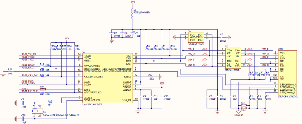

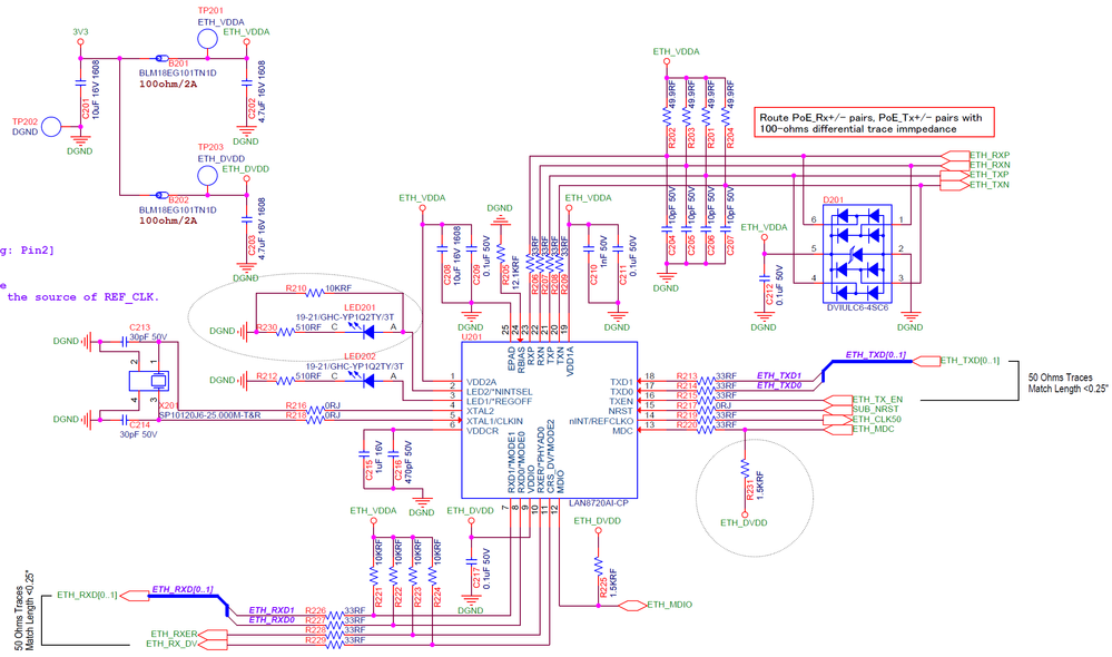

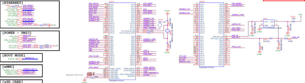

Currently, my ethernet circuit configuration is as the attached picture.
0693W00000DlwNsQAJ.png0693W00000DlwK8QAJ.pngAccording to the configuration, the Device Tree has been changed to the first configuration in your link.
I am using Distribution Package, and I am using Cube-MX by changing the Device Tree of 157F-EV to fit my circuit (meta-st-stm32mp-addons/mx Directory)
In the team project circuit, MPU and Ethernet IC exist on the same board, but The RJ45 connector is connected to the Ethernet IC through two boards.
So I'm thinking it's a circuit problem like impedance or noise.
However, I'm assuming it may be a problem with the BSP configuration.
So I would like to know if there is another Test method, and need to change the BSP configuration.
If you need, I can attach my MX Device Tree.
Regards.

From HW point of view, I did not see any evident issue.
Please double check the magnetic transformer and RJ45 pinout which are not part of this abstract, maybe some mixed-up there.
I don't think noise or impedance could make it not working at all.
If it helps, here is one of our RMII reference design working with the first link DT
0693W00000DlwrxQAB.pngRegards.
