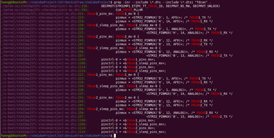

I have the same issue with the stm32mp157c-DK2 and I'm not sure where this block belongs
&m_can2 {
	clocks = <&scmi_clk CK_SCMI_HSE>, <&rcc FDCAN_K>;
 @Huibean created their own dts file with the tool but I'm trying to do this with the files that are already there. I guess it doesn't matter which dts file I use but I do need to feed the resulting dtb file to the correct stage in the boot chain, right? Which dtb file do I need to create and at what stage do I load it?
I am using yocto & OpenStLinux Dev Package.
I put it in the top dts file, ie. stm32mp157c-dk2.dts in your case

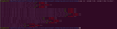

I dont think it matters where in the dts file it goes, the question is in which one? The file you named exists in multiple places to create different dtb files for the various boot stages.
Here is what I'm working with in Yocto:
@Erwan SZYMANSKI mentioned needing to add it to st,clksrc so I grepped this dir for that string and came up with this.
I decided to work with the CubeMX tool to see what it generated. I get a similar directory structure as above with the addition of optee-os. When I grepped the root dir for fdcan, the only instance of CLK_FDCAN (or anything can+clk) is in the optee-os directory.
so I'm still not sure where to put it in order to make dtc happy with the includes and then where to put the resulting dtb, either manually or through the bitbake automation.
