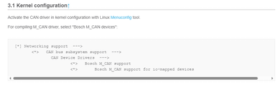

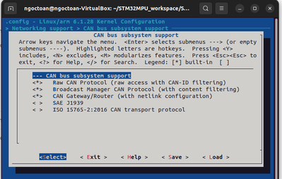

hi, I have a problem when controlling FDCAN, there is no option as instructed
