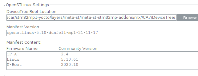

However, when I booting up the device, I received
ERROR: Failed to allocate 0x11e99 bytes below 0xd0000000.
After checking, It found that the cubeMX generate the dts assuming that I am using openstlinux5.10.
0693W00000KaWAoQAN.pngHow should I configure the cubeMX so that it generate 5.04 version dts?
It seems that everything is hardcoded.
Regards,
Leung
Hello @WLeun.3​ ,
You have to use the version of CubeMX delivered with your OSTL (5.4) version which is the STM32CubeMX6.1.
Wiki: https://wiki.st.com/stm32mpu-ecosystem-v2/wiki/STM32MP15_ecosystem_release_note_-_v2.1.0#STM32CubeMX
STM32CubeMX v6.1 -> This one generates Device tree compliance with openstlinux-5.4-dunfell-mp1-20-11-12 tag
To my knowledge there is no other way to use an old version of OpenSTLinux.
