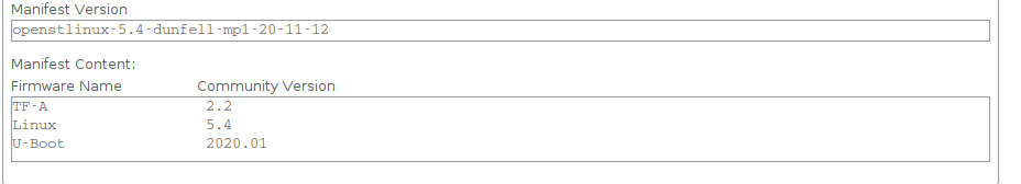

Hello @WLeun.3​ ,
You have to use the version of CubeMX delivered with your OSTL (5.4) version which is the STM32CubeMX6.1.
Wiki: https://wiki.st.com/stm32mpu-ecosystem-v2/wiki/STM32MP15_ecosystem_release_note_-_v2.1.0#STM32CubeMX
STM32CubeMX v6.1 -> This one generates Device tree compliance with openstlinux-5.4-dunfell-mp1-20-11-12 tag
To my knowledge there is no other way to use an old version of OpenSTLinux.

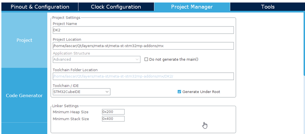

Hi Kevin,
My problem was that I didn't re-export my MACHINE variable, as MACHINE=stm32mp1-<ProjectName>.

Hello @WLeun.3​ ,
I think that your error is related to:
you have to browse with CubeMX until the folder "<path of STM32MP1_Distribution_Package>/layers/meta-st/meta-st-stm32mp-addons/mx/"
  • At build 3 sub-folders are created and populated with generated device tree files :
- <ProjectName>/kernel
- <ProjectName>/u-boot
- <ProjectName>/tf-a
Where <ProjectName> is the “STM32CubeMX user project name�?
Do you have something in your folder "<path of STM32MP1_Distribution_Package>/layers/meta-st/meta-st-stm32mp-addons/mx/" ?
Because the error seems to indicate that these 3 folders haven't be created by CubeMx.

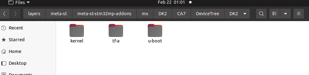

Hi @Kevin HUBER​,
I didn't find any mistake by myself.
Could you help take a look? Thanks

Hi @WLeun.3​ ,
In the path expected by the build, the folder DeviceTree is before CA7, but in your environment, the folder CA7 is the first one.
I will check my configuration to verify If your configuration is the right one, or if it is the one from the recipe.

Hello @WLeun.3​ ,
Please can you verify your variable CUBEMX_PROJECT from your .conf file of your MACHINE.
This variable must be set to the path where CubeMx generated the DTS.
In your case it must be:
CUBEMX_PROJECT = "mx/DK2/CA7/DeviceTree/DK2"
The recipe that throw the error is: "layers/meta-st/meta-st-stm32mp-addons/classes/cubemx-stm32mp.bbclass", line 53
Regards,
Kevin
