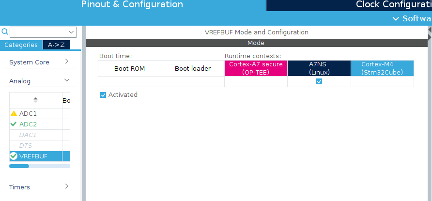

To be able to get a usable value by reading the ADC, you must have a reference which is VREFBUF.
I advice you to read the reference manual (RM0436 revision 5) page 1693: https://www.st.com/resource/en/reference_manual/DM00327659-.pdf
and the ADC page on the wiki: https://wiki.st.com/stm32mpu/wiki/ADC_internal_peripheral#Features
Then you have two choices to enable VREFBUF.
  • Engineering mode (without Linux)
If you are not using linux you have to enable the VREFBUF after the ADC_Init() but before starting it:
  __HAL_RCC_VREF_CLK_ENABLE(); // Enable the VREF clock
  HAL_SYSCFG_VREFBUF_HighImpedanceConfig(SYSCFG_VREFBUF_HIGH_IMPEDANCE_DISABLE); // Disable the high impedance mode which is the default one read page 1694 of refman
  HAL_SYSCFG_VREFBUF_VoltageScalingConfig(SYSCFG_VREFBUF_VOLTAGE_SCALE1); // To set the volage to 2.5v
  HAL_SYSCFG_EnableVREFBUF(); // To enable VREFBUF
Then you must calibrate your adc before using it:
  if(HAL_ADCEx_Calibration_Start(&hadc1, ADC_CALIB_OFFSET_LINEARITY, ADC_SINGLE_ENDED) != HAL_OK)
      /* Calibration Error */
      Error_Handler();
And finally you can use the code that you wrote in your first post to read the value.
  • In Production mode (with linux running):
You have to enable VREFBUF in the DTS for making it startable by Linux, you can enable it with CubeMx.
Then you have to configure the VREFBUF, I advise you to read this page:
https://wiki.st.com/stm32mpu/wiki/Regulator_overview#Microcontroller_device_internal_regulator
In a first time, I advise you to start by testing your code in engineering mode.
Note that this is setting VREF+=2.5V, so conversion range between 0 and 2.5V.

@Kevin HUBER​ wouldn't I want to set the voltage reference to 0v?
How do I calculate the max value? If I set to 2.5 ref, I have tested that ~3.8v returns 4096, but if I go down to 2.5v, I see a value of about 120. Even stranger as I increase voltage from 2.5 to 3.8, I don't really see a linear increase.
Btw, I'm using ADC now as I need a faster value reading rate than callbacks provided.
Ok, I guess 2.5 is a max, not a min. I was not getting useable results b/c I was using ANA1 and as per the docs that should be A3, but it is actually A2.
Hello @msche.1​ ,
Regarding your question about "engineering" mode and "production" mode, you have an explanation here: https://wiki.st.com/stm32mpu/wiki/STM32CubeMP1_development_guidelines#Cortex-M4_Startup_Engineering_mode_-28-E2-80-9CMCU_Single_Core_like-E2-80-9D-29
To sum up quickly, engineering mode is for debug purpose with only your M4 Firmware running on your board. You have access to all the peripherals.
In Production mode, the Linux is running in parallel of you M4 firmware on the board. You have to be careful to assign the peripherals needed to your firmware to the M4 CORE and avoid using these peripherals in the A7 CORE. Same for all the resources that can be accessed by the two sides.
You can find more information about peripheral assignment in the wiki: https://wiki.st.com/stm32mpu/wiki/ETZPC_internal_peripheral
Yes, the reference is the maximum that can be measured.
