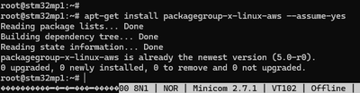

‎2024-05-20 6:18 PM
Hello, @Jean-Marc B
I try to your guide. X-LINUX-AWS_Starter_package
<Command>
cd /var/cache/apt/archives
wget http://extra.packages.openstlinux.st.com/AWS/5.0/pool/config/a/apt-openstlinux-aws/apt-openstlinux-aws_1.0_armhf.deb
apt-get install ./apt-openstlinux-aws_1.0_armhf.deb
<Install error>
packagegroup-x-linux-aws : Depends: demo-application-aws but it is not going to be installed
Depends: opensc but it is not going to be installed
Depends: optee-client (>= 3.19.0+git0+140bf46304-r1) but 3.19.0+git0+140bf46304-r0 is to bed
Depends: optee-os-stm32mp (>= 3.19.0-stm32mp-r1-r1) but 3.19.0-stm32mp-r1-r0 is to be instad
Depends: pcsc-lite but it is not going to be installed
Depends: pkcs11-provider but it is not going to be installed
E: Unmet dependencies. Try 'apt --fix-broken install' with no packages (or specify a solution).
how can I fix it? thanks.
‎2024-05-21 12:36 AM
Hi @younghan
Hum, that's ssuper strange!
I just flashed a mp135f-dk board with OpenSTLinux 5.0 and followed the wiki instructions without reproducing your problem. My commands:
root@stm32mp1:~# date
root@stm32mp1:~# apt-get update
root@stm32mp1:~# apt-cache policy optee-client optee-os-stm32mp
optee-client:
Installed: 3.19.0+git0+140bf46304-r0
Candidate: 3.19.0+git0+140bf46304-r0
Version table:
*** 3.19.0+git0+140bf46304-r0 100
100 /var/lib/dpkg/status
optee-os-stm32mp:
Installed: 3.19.0-stm32mp-r1-r0
Candidate: 3.19.0-stm32mp-r1-r0
Version table:
*** 3.19.0-stm32mp-r1-r0 100
root@stm32mp1:~# wget http://extra.packages.openstlinux.st.com/AWS/5.0/pool/config/a/apt-
root@stm32mp1:~# mv apt-openstlinux-aws_1.0_armhf.deb /var/cache/apt/archives/.
root@stm32mp1:~# apt-get install /var/cache/apt/archives/apt-openstlinux-aws_1.0_armhf.de
b
optee-client:
Candidate: 3.19.0+git0+140bf46304-r1
Version table:
3.19.0+git0+140bf46304-r1 500
500 http://extra.packages.openstlinux.st.com/AWS/5.0 mickledore/main armhf Packages
optee-os-stm32mp:
Candidate: 3.19.0-stm32mp-r1-r1
Version table:
3.19.0-stm32mp-r1-r1 500
root@stm32mp1:~# apt-get install packagegroup-x-linux-aws --assume-yes
Would it be possible to make a new attempt from a fresh installation please?
Best regards,
--JM

Yes, I want to STM32MP13 to connect to the AWS Cloud (AWS IoT Core).
‎2024-05-21 2:21 AM
Hello @younghan,
Thank you for your interest to the X-LINUX-AWS expansion package.
You can find the documentation entry point of this package here: https://wiki.st.com/stm32mpu/wiki/Category:X-LINUX-AWS_expansion_package
Because you have already installed the package, you can go to the configuration step: https://wiki.st.com/stm32mpu/wiki/X-LINUX-AWS_Expansion_Package#X-LINUX-AWS_Expansion_Package_software_setup
