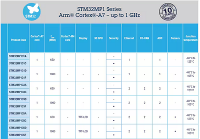

Looking at AN5478 implies that the entire line of STM32MP13x has a DCMIPP interface. However for STM32MP131 DCMIPP is not mentioned in the datasheet.
Does the STM32MP131 have a DCMIPP interface? If so, are the pins and the functionality matching that on the one on the STM32MP135?
Thanks.

AN5478 is generic for the STM32MP13x family, you should refer to datasheet or product selector to look for available features.
Only STM32MP135 has camera interface.
https://www.st.com/en/microcontrollers-microprocessors/stm32mp1-series.html
Anyway, I note that to clarify AN5478 scope in future release.
