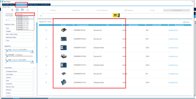

can you please suggest me a best stm32processor board which has adc and dac and usb port, ethernet wifi which uses stm32cube ide
mƎALLEm
You can use CubeMx for this kind of request. Select Board Selector and write "STM32MP":
These are the available boards for MP products.
Then select a boards and check if it does fit your requirements:

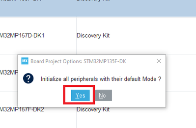

So double click on one board, and click Yes:

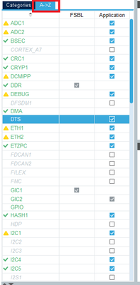

In the "Pinout & Configuration" tab / "A-Z", you will find all the available peripherals that you can use at the same time.

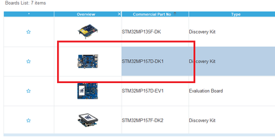

and I think STM32MP157D-DK1 fits your requirements:
For DAC, you need just to fix the conflicts with ADC1 and ADC2 (attached an ioc file).
No WiFi available unless you add a module.

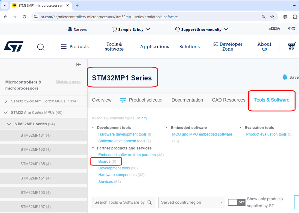

On ST's pages for each of the STM32MPxx Lines you've tagged, go to the 'Tools & Software' tab - there's a link there for available boards:
See which of those meet your requirements ...
