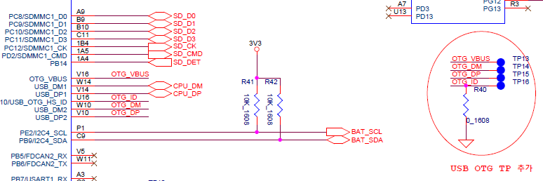

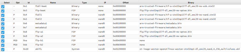

NAND is used, there is no difference compared to the EV board TSV.
And the USB port was used as a test point without using a connector.
​Finally, I did a pull-up on UART PA13, but no data is output. I wonder if there is a separate setting to use.
It uses NAND flash for storage. Does this happen if there is no communication with the NAND flash?
At that stage of error (TF-A-usb seems not to answer), you not have yet loaded uBoot, so NAND is not involved as Flash programming is done by uBoot.

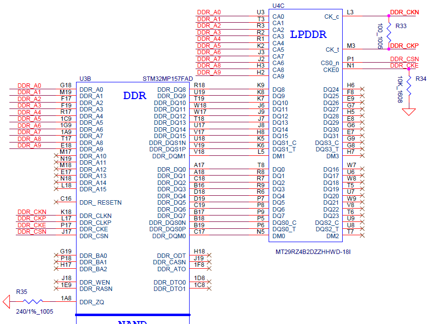

Actually we are using 32-bit DDR2 RAM and 8x 4G-bit NAND, but MP157x only support 16-biy RAM. Can this be the problem?

At that stage, it is not an isue with NAND, but as you have no console output at all, you might have multiple issues:
  • TF-A Device Tree issues
  • corrupted/misformed TF-A during compilation
  • TF-A header issue (added by signing tool during compilation flow)
  • issue with DDR settings
  • issue with DDR PCB signal integrity
For DDR settings/tests on a custom board, we strongly recommend using first CubeMX/DDRTools together with DDRFW-UTIL https://wiki.st.com/stm32mpu/wiki/STM32DDRFW-UTIL.
DDRFW-UTIL will be loaded instead of TF-A and allow to run some low level DDR test while allowing to modify default DDR settings in CubeMX.
Btw, I'm not sure your setup of using a 32-bits LPDDR and using only 16-bits could work (at least we did not try it). This will requires clever and custom settings to make it working.
