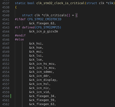

Is the source code located at
.../workspace/sources/optee-os-stm32mp/core/drivers/clk/clk-stm32mp25.c?
Could you please provide specific instructions on how to modify the source code?
I’ve tried various approaches, but the build still fails.
Best regards,
OKN
Hello @OKN ,
Yes you target the right file, the modification should be as below:
The added line is highlighted by the green marker on the left.
Kind regards,
Erwan.
Hello @Erwan SZYMANSKI
I tried adding ck_flexgen_34.
There doesn't seem to be any change in the boot log.
Best regards,
OKN
static bool clk_stm32_clock_is_critical(struct clk *clk)
	struct clk *clk_criticals[] = {
		&ck_hsi,
		&ck_hse,
		&ck_msi,
		&ck_lsi,
		&ck_lse,
		&ck_cpu1,
		&ck_icn_p_syscpu1,
		&ck_icn_s_ddr,
		&ck_icn_p_ddrc,
		&ck_icn_p_ddrcfg,
		&ck_icn_p_ddrphyc,
		&ck_icn_s_sysram,
		&ck_icn_s_bkpsram,
		&ck_flexgen_34,

As a test, I removed ck_flexgen_34 and added ck_icn_p_pci.
No SERC error occurred.
It crashes immediately, but u-boot booted successfully.
Is there any connection between the changes resulting from adding ck_icn_p_pci and the SERC error?
Best regards,
OKN
		&ck_hsi,
		&ck_hse,
		&ck_msi,
		&ck_lsi,
		&ck_lse,
		&ck_cpu1,
		&ck_icn_p_syscpu1,
		&ck_icn_s_ddr,
		&ck_icn_p_ddrc,

		// &ck_flexgen_34,
		&ck_icn_p_pcie,
NOTICE:  CPU: STM32MP255FAK Rev.Y

Regarding the SERC exception, I resolved it by modifying the optee-os source code, but is there a way to handle this using DeviceTree or STM32CubeMX without modifying the source code?
Best regards,
OKN
